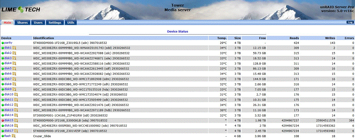

What does your webgui main page show?
Everything looks in order on the Main tab. All drives are there and the size and free space all looks correct. I can also view the contents of each disk by clicking on the folders.

So much for that. Just had some errors pop up with just a few hours left. 512 on disk 15, 256 on disk 16, 256 on disk 17. I stopped the array and then 15 was showing "not installed" and 16 and 17 were "missing". Restarted the array and 16 and 17 are there again and 15 has to be rebuilt.
