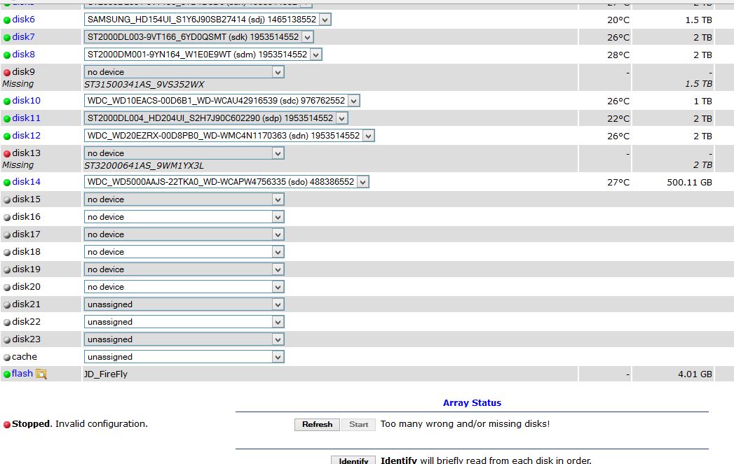

i don't can do this....
when i remove both disks..it gives me a error that the config is bad
i don't can unassign....it call always " no device "...

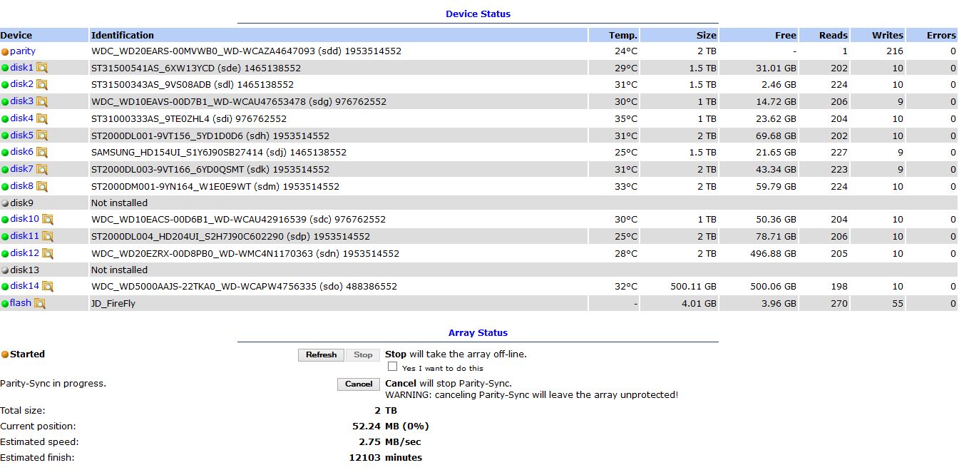

parrity is running now....i say when its ready
thx a lot
lol...we talk in a  week  :o
current 4% ... i'm waiting...at this speed ....next weekend

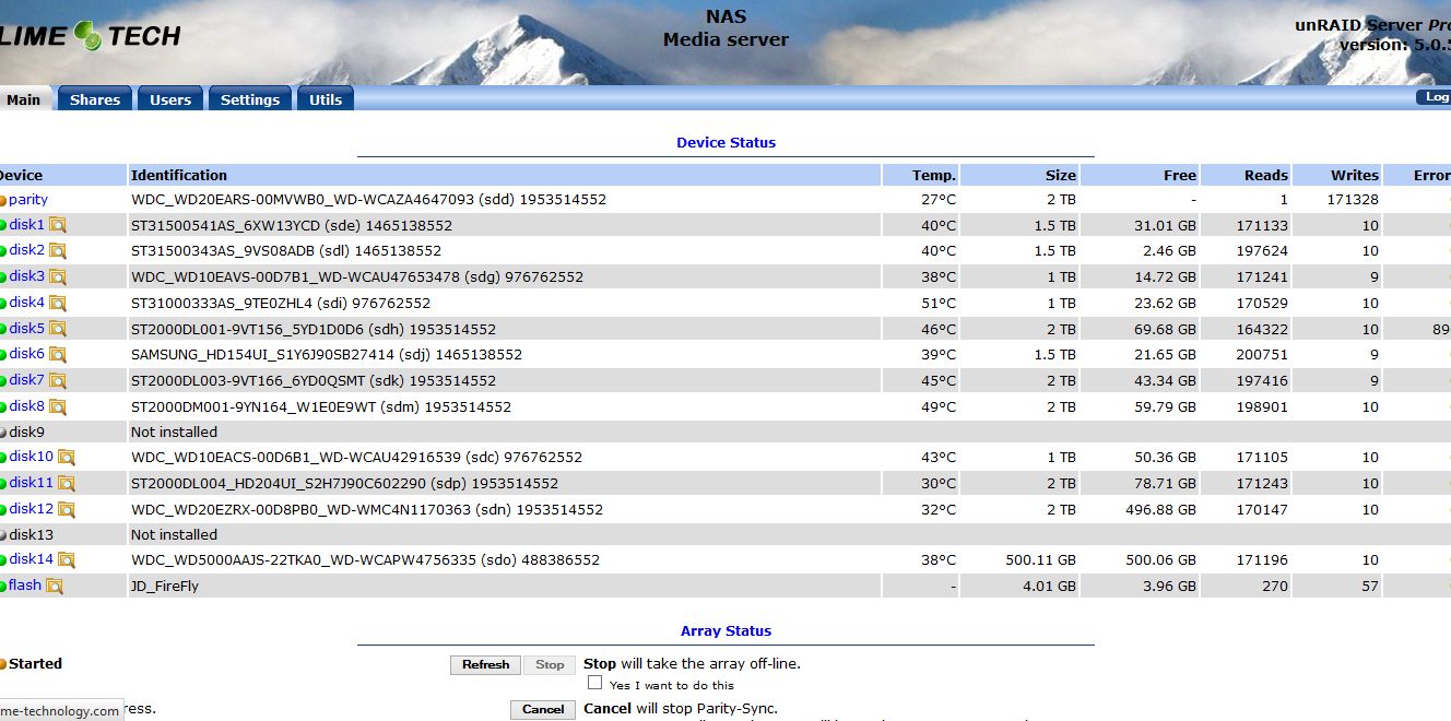

and disk 5 gives errors ???......is that because the other disks are missing?

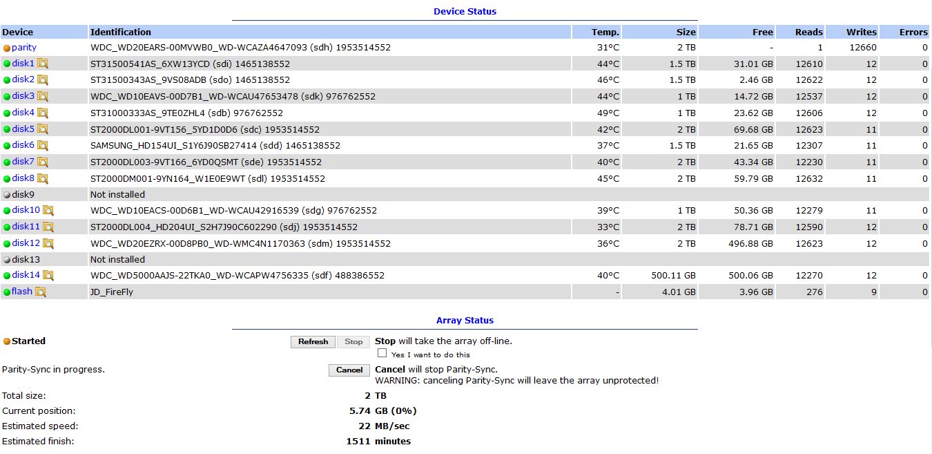

Probably still have some sort of problem going on if parity is taking that long. What is your hardware?
no, no new errors...
but very very slow....current 7%...

Jan  5 16:25:58 NAS kernel: ata7.00: BMDMA2 stat 0x616d0009 (Drive related)
Jan  5 16:25:58 NAS kernel: ata7.00: failed command: READ DMA EXT (Minor Issues)
Jan  5 16:25:58 NAS kernel: ata7.00: cmd 25/00:00:27:7b:b2/00:04:10:00:00/e0 tag 0 dma 524288 in (Drive related)
Jan  5 16:25:58 NAS kernel:          res 51/04:30:f7:7e:b2/00:00:10:00:00/e0 Emask 0x1 (device error) (Errors)
Jan  5 16:25:58 NAS kernel: ata7.00: status: { DRDY ERR } (Drive related)
Jan  5 16:25:58 NAS kernel: ata7.00: error: { ABRT } (Errors)
Jan  5 16:25:58 NAS kernel: ata7.00: configured for UDMA/33 (Drive related)
Jan  5 16:25:58 NAS kernel: ata7: EH complete (Drive related)
Jan  5 16:25:58 NAS kernel: ata7: drained 65536 bytes to clear DRQ (Drive related)
Jan  5 16:25:58 NAS kernel: ata7.00: exception Emask 0x0 SAct 0x0 SErr 0x0 action 0x6 frozen (Errors)
Jan  5 16:25:58 NAS kernel: ata7.00: cmd 25/00:00:27:7f:b2/00:04:10:00:00/e0 tag 0 dma 524288 in (Drive related)
Jan  5 16:25:58 NAS kernel:          res ff/ff:ff:ff:ff:ff/ff:ff:ff:ff:ff/ff Emask 0x2 (HSM violation) (Errors)
Jan  5 16:25:58 NAS kernel: ata7.00: status: { Busy } (Drive related)
Jan  5 16:25:58 NAS kernel: ata7.00: error: { ICRC UNC IDNF ABRT } (Errors)
Jan  5 16:25:58 NAS kernel: ata7: hard resetting link (Minor Issues)
Jan  5 16:25:59 NAS kernel: ata7: SATA link up 1.5 Gbps (SStatus 113 SControl 310) (Drive related)
Jan  5 16:25:59 NAS kernel: ata7.00: configured for UDMA/33 (Drive related)
Jan  5 16:25:59 NAS kernel: ata7: EH complete (Drive related)
Jan  5 16:25:59 NAS kernel: ata7.00: exception Emask 0x0 SAct 0x0 SErr 0x0 action 0x0 (Errors)
Jan  5 16:25:59 NAS kernel: ata7.00: BMDMA2 stat 0x686d0009 (Drive related)
Jan  5 16:25:59 NAS kernel: ata7.00: failed command: READ DMA EXT (Minor Issues)
Jan  5 16:25:59 NAS kernel: ata7.00: cmd 25/00:00:27:83:b2/00:04:10:00:00/e0 tag 0 dma 524288 in (Drive related)
Jan  5 16:25:59 NAS kernel:          res 51/04:a0:87:83:b2/00:03:10:00:00/e0 Emask 0x1 (device error) (Errors)
Jan  5 16:25:59 NAS kernel: ata7.00: status: { DRDY ERR } (Drive related)
Jan  5 16:25:59 NAS kernel: ata7.00: error: { ABRT } (Errors)
Jan  5 16:26:29 NAS kernel: ata7.00: exception Emask 0x0 SAct 0x0 SErr 0x0 action 0x6 frozen (Errors)
Jan  5 16:26:29 NAS kernel: ata7.00: failed command: READ DMA EXT (Minor Issues)
Jan  5 16:26:29 NAS kernel: ata7.00: cmd 25/00:00:27:83:b2/00:04:10:00:00/e0 tag 0 dma 524288 in (Drive related)
Jan  5 16:26:29 NAS kernel:          res 40/00:a0:87:83:b2/00:03:10:00:00/e0 Emask 0x4 (timeout) (Errors)
Jan  5 16:26:29 NAS kernel: ata7.00: status: { DRDY } (Drive related)
Jan  5 16:26:29 NAS kernel: ata7: hard resetting link (Minor Issues)
Jan  5 16:26:29 NAS kernel: ata7: SATA link up 1.5 Gbps (SStatus 113 SControl 310) (Drive related)
Jan  5 16:26:29 NAS kernel: ata7.00: configured for UDMA/33 (Drive related)
Jan  5 16:26:29 NAS kernel: ata7: EH complete (Drive related)
Jan  5 16:26:29 NAS kernel: ata7.00: exception Emask 0x0 SAct 0x0 SErr 0x0 action 0x0 (Errors)
Jan  5 16:26:29 NAS kernel: ata7.00: BMDMA2 stat 0x616d0009 (Drive related)
Jan  5 16:26:29 NAS kernel: ata7.00: cmd 25/00:00:27:8b:b2/00:04:10:00:00/e0 tag 0 dma 524288 in (Drive related)
Jan  5 16:26:29 NAS kernel:          res 51/04:20:07:8e:b2/00:01:10:00:00/e0 Emask 0x1 (device error) (Errors)
Jan  5 16:26:29 NAS kernel: ata7.00: status: { DRDY ERR } (Drive related)
Jan  5 16:26:29 NAS kernel: ata7.00: error: { ABRT } (Errors)
Jan  5 16:26:29 NAS kernel: ata7.00: BMDMA2 stat 0x686d0009 (Drive related)
Jan  5 16:26:29 NAS kernel:          res 51/04:c0:67:8b:b2/00:03:10:00:00/e0 Emask 0x1 (device error) (Errors)
hardware:
Intel® Celeron® CPU        E1500  @ 2.20GHz
3 sata controller
for more information i must look
my hardware are collected the last years :-)....every year one new....when i have money

ok...memtest was great..no errors....
than i test the hardware.....i mean i have found the problem....every time i have an error on one disk and the same controller (Ultron US-220 2x sata Controller)
i put it out of my server an the disks at the SAS Controller.
and now i have the parity start with a nice speed :)
look picture
in the syslog only minor issues....is that ok?
