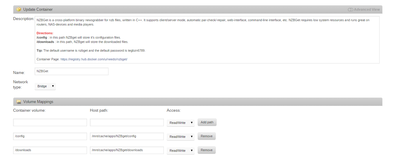

NZBget docker is up and running... NZBget options confused me, but whatevs...
Sonarr sent NZBs to docker no problem.

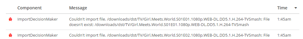

Once they are downloaded Sonarr can't import them because of the differnce between the container path and the host path... how do you solve this?
I mount /downloads to mnt/cache/downloads in both Sonarr and NZBget then when NZBget says, "Hey Sonarr that stuff you asked for I downloaded it and left it in mnt/cache/downloads" then Sonarr says "I got it, Thanks" as they both will have the same location in their mappings for /downloads, at the moment you've mapped /downloads to two different places.
So NZBGet thinks /downloads means one place and Sonarr thinks it's in a completely different place.
This is one thing with docker you need to get your head around rather than a Sonarr or Nzbget thing mappings need to be transferable and identical between containers.
There is another way around it but it's way more complicated. And involves an advanced option in Sonarr.

Go to Sonarr - settings - download client enable advanced options then set remote path mappings.
That's a reason for running Dockers for both. Still, NZBget appears to returning a path starting with /downloads which is how you need the path to start in Sonarr so it should be close to working.  But something isn't correct in the string.
If you go to the Settings in Sonarr and pick the Download Client tab then click on the folder beside the Drone Factory line near the bottom you can start going through the downloads directory structure and see what the Sonarr path is to the directory storing the file.
