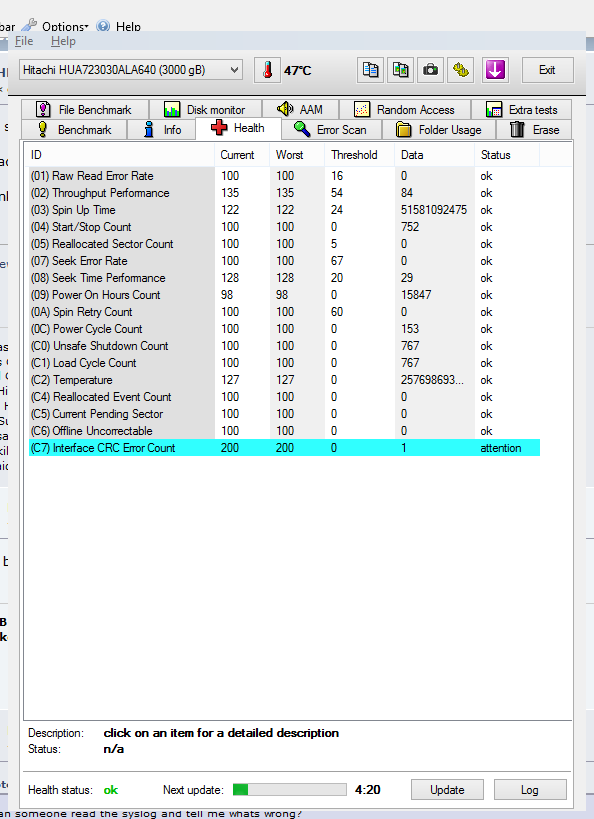

I will shut down the server and check the smart of the the failed drive. If there is nothing wrong with smart, shall I put the drive back and rebuild it?
He is the smart for drive 6.

Drive might not have been sitting quite right in it.  Still could be power issues or a bad backplane.  Definitely try reseating the drive and/or use a different slot.
The smart looks ok for the drive (although I have no idea why the temperature is hotter than the sun)  To rebuild onto itself, you'll have to stop the array, set disk6 to be not installed, start the array, stop the array, and then set disk6 to be that drive.  Start the array and it will begin to rebuild.

You're probably good with that supply (although ALL power supplies do lose capacity as they age).  Your syslog is clean.  No hardware errors for the drives.
