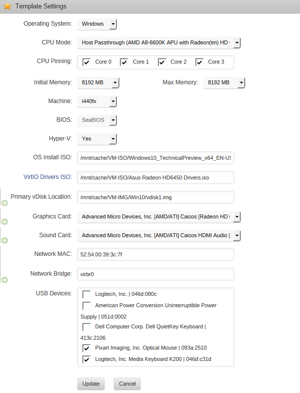

Finally I got one GPU to pass through the only issue is that I cannot install the display drivers in a Win10 VM in order to get the full resolution this card can provide. Right now I'm stuck with a generic windows driver.
If I try to install the drivers from the provided CD the VM is freezing and eventually the whole system will restart.
Am I doing something wrong here or should I start looking maybe at a different motherboard.
Thank you.
