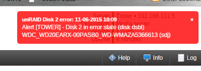

And here's the screen shot

unRAID disables a disk when a write to it fails. While disabled, unRAID will emulate the drive by using all the other drives plus parity. When the emulated disk is read, what actually happens is all of the disks plus parity are read, and from that the data for the disk can be calculated. When the emulated disk is written, what actually happens is all of the disk plus parity are read, and from that plus the data to be written, the parity change can be calculated and written. So, reads and writes can still happen, but they don't actually happen on the disabled drive.
You will have to rebuild the drive. Do you have a spare?
- I do not.  It's been a while since I last had to do a rebuild...can I just reuse the one that's in there?
