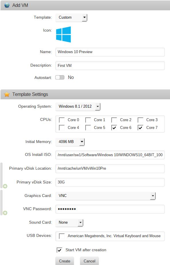

I am about to create my first unRAID VM and have some what I think is a very basic question.
I am not looking to pass through anything. I just want to create a VM that I can access using VNC.
I am trying to use the Windows 10 preview .ISO
I have enabled VMs, and filling out the VM settings (see attachment).
My question is what do I do after hitting create. It says it is going to start the VM. How will I connect to it to be able to complete the Windows install process. I have the RealVNC client installed on my Windows machine that I would like to use to access it. How will I designate the "VNC Server"? Is there any manual editting of XML files that I need to do before starting the VM?
Thanks for help getting me started.
No manual editing of XML. After you create the VM and are returned to the VMs page, click the icon for the VM, then click VNC.
