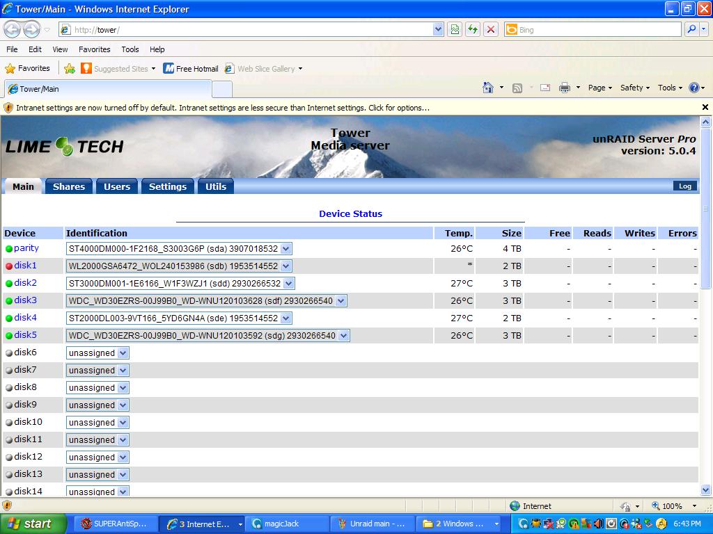

August 1, 201511 yr Author trurl, I sent the screen shot you requested. Is there any thing further I need to do? Can you tell me the next step? Howard
August 1, 201511 yr http://lime-technology.com/wiki/index.php/Troubleshooting#What_do_I_do_if_I_get_a_red_ball_next_to_a_hard_disk.3F
August 11, 201511 yr Author trurl, again, sorry it took is so long. I was out again. rebuilt disk 1 and every thing is working fine. Thanks again, Howard
