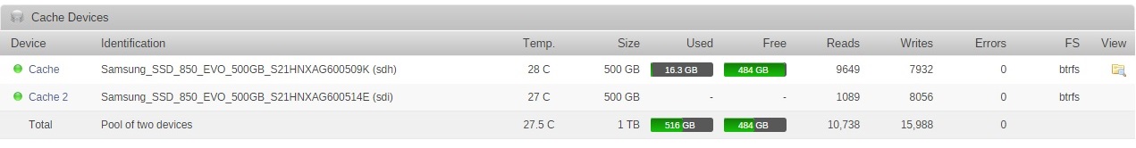

I just took two brand new 500GB SSDs and installed them in my server, created two cache slots, assigned the SSDs and started the array.  It said the first drive in the pool was unmountable and needed formatting so I did that.  I started using the cache to set up some dockers, etc. but then I looked at the dashboard and something doesn't seem right.
It shows that the size of the pool is 1TB (if this is RAID-1 shouldn't it be 500GB?).  Used and free space for cache drive look correct but on the "pool of two devices" line it shows 516GB used which makes no sense.

Makes sense to me, actually. But hey, I'm weird!  8)
The pool comprises two disks, 500GB each, so it has the size of 500GB+500GB=1000GB. How the 1000GB are used doesn't make any difference, there are still 1000GB in total in the pool.
Those 1000GB can be used in different ways. Since the pool is set to RAID-1 redundancy in this case, and the pool has two disks of equal size, half of that space is used for redundancy. This leaves 500GB to use for storage, and you use about 16GB of that for dockers and stuff, which leaves a total of 500GB-16GB=484GB free and 500GB+16GB=516GB used.
Totally normal.
Ok that logic makes sense... but why does the first cache drive show as unmountable and the system wants to format it when I unassign the cache 2 drive?  Shouldn't the data still be available on cache 1?  Isn't that the point of a redundant cache pool?
