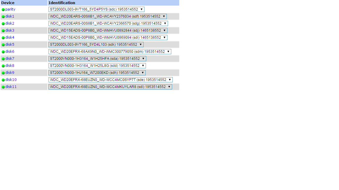

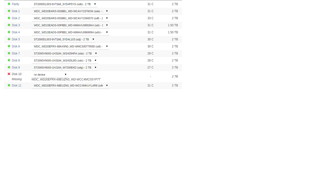

August 1, 201511 yr Trying to upgrade to the new version, all goes well except that a single drive is labeled as missing, but when reverting back to 5.0.6 all drives are seen and the array is fine
August 1, 201511 yr Please see Need help? Read me first!, and attach the diagnostics zip. One idea, perhaps the drive is attached to one of the suspect cards in this report. That would explain why it works in v5 but not v6. If it's on one of the suspect cards, you can confirm by turning off IOMMU.
August 1, 201511 yr Author The suspected drive is also attached to the onboard SATA along with these other 4 [*]ST2000VN000W1H25L8G (sdk) (2.0TB) WD20EFRX WCC4MC0SYP7T (sdm) (2.0TB) ST2000VN000b W1H25HFA (sdi) (2.0TB) ST2000DL0035YD4P5YS (sdj) Parity (2.0TB) [*]
August 4, 201511 yr Author Any idea on this? Switching back to 5.0.6 all drives are online and the array is fine, but going to 6.0.1 the one drive is missing. I have tried going back and forth a few times and its always the same issue. Should I remove the drive from the array in 5.0.6 and try adding it as a new drive in 6.0.1?

August 4, 201511 yr Author Diagnostics attached, oddly enough this time all disks are seen in the array devices listing, was able to start the array with no issues. Not sure if anything can be looked at in the diagnostics to see what happened the last couple times media-diagnostics-20150804-1311.zip
August 5, 201511 yr Diagnostics attached, oddly enough this time all disks are seen in the array devices listing, was able to start the array with no issues. Not sure if anything can be looked at in the diagnostics to see what happened the last couple times Always best to see the syslog that covers the period when the problem occurs. However, the new syslog does show something possibly mis-configured on that drive, perhaps causing inconsistent setup of it. From v5.0.6 - Aug 1 10:47:00 MEDIA kernel: ata4: SATA link up 3.0 Gbps (SStatus 123 SControl 300) Aug 1 10:47:00 MEDIA kernel: ata4.00: ATA-9: WDC WD20EFRX-68EUZN0, WD-WCC4MC0SYP7T, 82.00A82, max UDMA/133 Aug 1 10:47:00 MEDIA kernel: ata4.00: 3907029168 sectors, multi 1: LBA48 NCQ (depth 31/32) Aug 1 10:47:00 MEDIA kernel: ata4.00: configured for UDMA/133 Aug 1 10:47:00 MEDIA kernel: scsi 5:0:0:0: Direct-Access ATA WDC WD20EFRX-68E 82.0 PQ: 0 ANSI: 5 Aug 1 10:47:00 MEDIA kernel: sd 5:0:0:0: Attached scsi generic sg4 type 0 Aug 1 10:47:00 MEDIA kernel: sd 5:0:0:0: [sde] 3907029168 512-byte logical blocks: (2.00 TB/1.81 TiB) Aug 1 10:47:00 MEDIA kernel: sd 5:0:0:0: [sde] 4096-byte physical blocks Aug 1 10:47:00 MEDIA kernel: sd 5:0:0:0: [sde] Write Protect is off Aug 1 10:47:00 MEDIA kernel: sd 5:0:0:0: [sde] Mode Sense: 00 3a 00 00 Aug 1 10:47:00 MEDIA kernel: sd 5:0:0:0: [sde] Write cache: enabled, read cache: enabled, doesn't support DPO or FUA Aug 1 10:47:00 MEDIA kernel: sde: sde1 Aug 1 10:47:00 MEDIA kernel: sd 5:0:0:0: [sde] Attached SCSI disk From v6.0.1 - Aug 4 13:08:45 MEDIA kernel: ata4: SATA link up 3.0 Gbps (SStatus 123 SControl 300) Aug 4 13:08:45 MEDIA kernel: ata4.00: ATA-9: WDC WD20EFRX-68EUZN0, WD-WCC4MC0SYP7T, 82.00A82, max UDMA/133 Aug 4 13:08:45 MEDIA kernel: ata4.00: 3907029168 sectors, multi 1: LBA48 NCQ (depth 31/32) Aug 4 13:08:45 MEDIA kernel: ata4.00: n_sectors mismatch 3907029168 != 268435455 Aug 4 13:08:45 MEDIA kernel: ata4.00: revalidation failed (errno=-19) Aug 4 13:08:45 MEDIA kernel: ata4: limiting SATA link speed to 1.5 Gbps Aug 4 13:08:45 MEDIA kernel: ata4.00: limiting speed to UDMA/133:PIO3 ...[snipped, unrelated] Aug 4 13:08:45 MEDIA kernel: ata4: SATA link up 3.0 Gbps (SStatus 123 SControl 300) Aug 4 13:08:45 MEDIA kernel: ata4.00: configured for UDMA/133 Aug 4 13:08:45 MEDIA kernel: scsi 4:0:0:0: Direct-Access ATA WDC WD20EFRX-68E 0A82 PQ: 0 ANSI: 5 Aug 4 13:08:45 MEDIA kernel: sd 4:0:0:0: [sdi] 3907029168 512-byte logical blocks: (2.00 TB/1.81 TiB) Aug 4 13:08:45 MEDIA kernel: sd 4:0:0:0: Attached scsi generic sg8 type 0 Aug 4 13:08:45 MEDIA kernel: sd 4:0:0:0: [sdi] 4096-byte physical blocks Aug 4 13:08:45 MEDIA kernel: sd 4:0:0:0: [sdi] Write Protect is off Aug 4 13:08:45 MEDIA kernel: sd 4:0:0:0: [sdi] Mode Sense: 00 3a 00 00 Aug 4 13:08:45 MEDIA kernel: sd 4:0:0:0: [sdi] Write cache: enabled, read cache: enabled, doesn't support DPO or FUA Aug 4 13:08:45 MEDIA kernel: sdi: sdi1 Aug 4 13:08:45 MEDIA kernel: sd 4:0:0:0: [sdi] Attached SCSI disk Except for the part in bold it's essentially identical, should work fine but possibly a bit slower. I have no idea why a reported sector count mismatch (reported vs actual, I believe) should cause a speed drop, they're unrelated. Since it failed to set up in time once, and only succeeded this time after a delay and with a minor issue, I'm not sure you can count on the drive yet. Further testing should determine how reliably it shows up. You might try an hdparm option that reports most drive parameters, hdparm -I /dev/sd*, and compare it with the identical model, Disk 11.
August 6, 201511 yr Don't know what to say, looks identical. Might as well use and test it, but confidence in that drive is not high. Last option is give it a kick!
August 6, 201511 yr Author Thanks Rob for all the help, I will keep an eye on the drive and continue to use version 6. Ill mark the topic as solved
