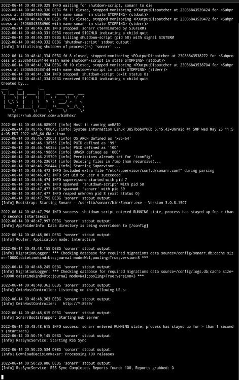

Hi, I have same problem. Don't get it.
I know, price of Gold Shovel ... :(
I have path in sonarr -folder for downloads:
/Downloads
but it is downloading to:
/Downloads/tv sonarr
In integration with plex are good folders like ../movies and ../series, but inside are only "link/shortcut" folders which are empty. Real stuff is still in .../tv sonarr
Also don't create folder for season in all series.
ps same in radarr
ed
Using qBittorrent
rTorrent and deluge - can't get  remote access which is obligatory for me (right now using Xpenology, but want combine 2 machine in one). Deluge is also not downloading enything...
Edited by lakimakromedia
extra info
