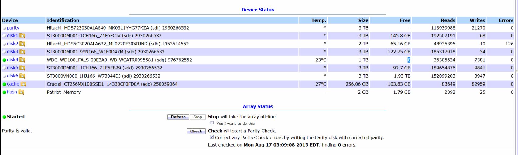

August 17, 201511 yr I had a power outage yesterday and when I brought up my unRAID server, I noticed that drive 2 shows errors. The Parity check ran finding 0 errors. My assumption is that I should just go ahead and replace the drive? I'm currently addressing the issue with Drive 4 not having any free space.
August 18, 201511 yr Author I'm thinking the drive is cooked, provided I did the SMART test correctly. I navigated to the unMENU page, then Disk Management and then chose the disk with the errors. I hit the Spin Up button followed by the Short SMART Test button. I waited the 2 minutes it said it would take and then hit the SMART History Report button. The output is attached. Syslog.txt SMART.txt
August 18, 201511 yr I'm thinking the drive is cooked, provided I did the SMART test correctly.Yep. Replace ASAP. Hope your other drives are healthy. You should thoroughly test the new drive before trusting it, the preclear script is good for that. A rebuild candidate doesn't need the clearing part, but the testing part is valuable. After the rebuild is done, do a non-correcting parity check to make sure the rebuild went well. If you don't have good backups of important stuff, now is the time to do it, while the array is still up.
