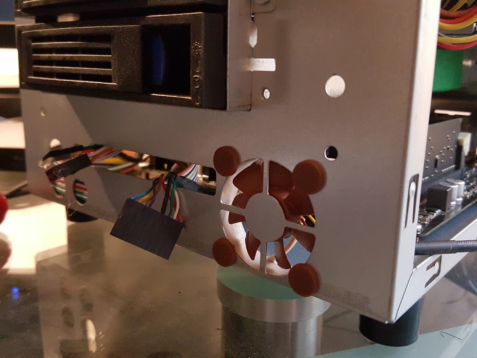

So I don't know how I missed this before, but there is a spot for a 40mm fan to mount onto the inside-front of this case.  It just so happens that I have a Noctua 40mm fan not being used, so I went ahead and installed it.  I also taped up a couple more spots inside the case to further promote airflow over the drives.  The places I taped would normally result in almost no airflow over the processor/ram, but since I have the little 40mm fan blowing now, I figure I can get away with it.  I've never seen that processor get over 50C.

Good find, Now I understand why the airflow wasn't enough through the drives.
Is the CPU cooled with a fan or is it passive?
Love that spot fan, you may need to use something like that to direct flow. However if the air outside is cool enough, I bet the lil exhaust fan and the large exhaust fan will create enough air flow to keep it cool inside. you may need to consider the direction of airflow and use the spot fan to push it that direction.
The CPU is passive.  I've been really impressed with it so far, not that I'm taxing it by any means.  I might install Plex at some point just to see if it can transcode.
I actually have the 40mm blowing into the case, not exhausting.  I went back and forth about it, but since it's at the bottom of the case, the fiercely debated convention is to blow air in.  Honestly that 40mm doesn't move enough air that in vs out would make much of a difference, especially since I have it at half throttle via BIOS.  The open pci slot (due to the 120mm fan cable) acts as the exhaust for the air that the 40mm is pushing through the bottom of the case.
