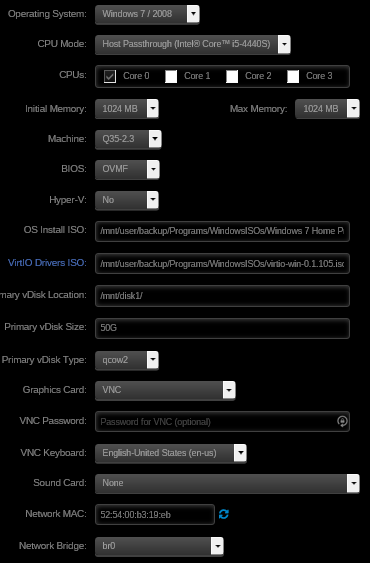

I'd gotten a message about not being able to allocate the memory when I first tried, so I changed initial from 512 to 1024 and max from 3072 to 2048 and tried saving again, now I get the attached error window.
I've attached the settings I'm trying to use also.

Multiple problems here:
1 - Windows 7 does not work with UEFI.  There is hackery involved to even try to make it work and no, we haven't tested it nor is it supported.
2 - There is an issue with using Q35 and OVMF and Windows based guests.  Don't use it.  Also, for non-Windows guests, after defining the VM (without creating), you need to edit the XML and manually remove the ide controller from the VM XML manually.
3 - Unless you are having an issue, do NOT use Q35 (at all).
FYI, I am working on a wiki page that has more details on supported Windows guest configurations.  You can view my WIP here:
http://lime-technology.com/wiki/index.php/UnRAID_6/VM_Guest_Support

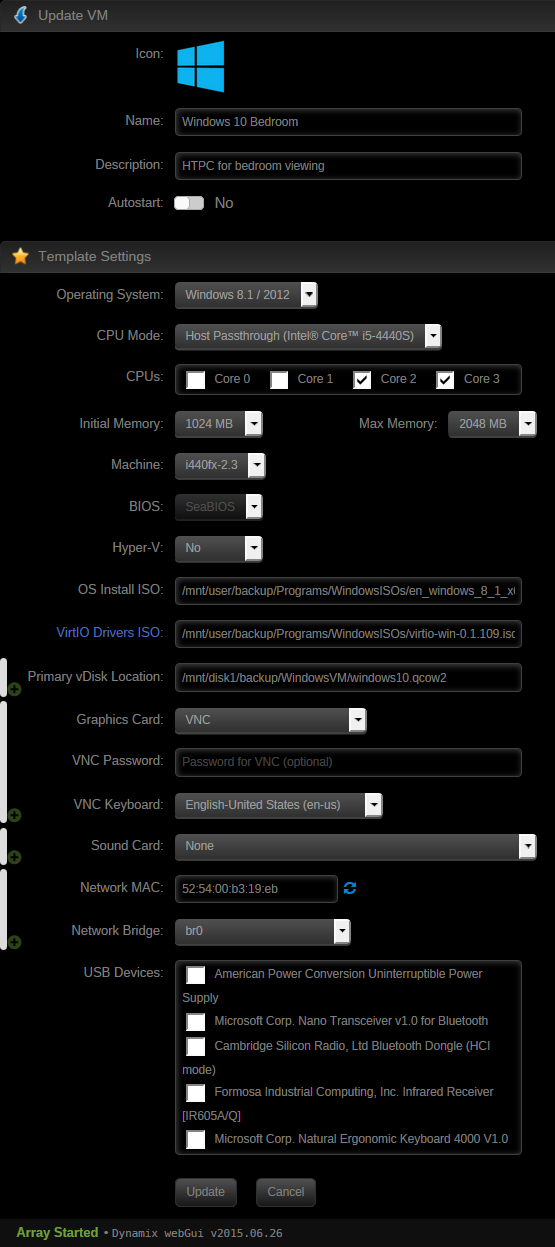

Sadly, I'm not able to load any of the drivers.  I've tried loading windows7 and windows10, but both are unsuccessful when I try to load the balloon and the NetKVM drivers.  it doesn't matter which order I try, no drivers actually get loaded.  The .109 drivers don't have a section for Windows10, so i tried windows 7, 8 and 8.1 and all fail.
I wonder if it's a problem with the machine type I'm trying to use (i440fx-2.3).
Any other suggestions/ideas on what to try?
Thanks jonp, the wiki you created is great, thanks for the link.

Nope, I changed to seabios.
Please explain "unsuccessful"?  Can you take a screenshot of what you see?
No problem with the machine type.  Works fine for me 100% of the time.
The NetKVM nor the balloon drivers are required for a Windows installation to complete.  The only driver that actually must be loaded prior to the install would be viostor.
Also, want to make sure that when you are browsing the folders, you are browsing to the amd64 folder, not the x86 folder.
When I launch the VM, it takes me to the windows installation screen.  There is no disk to install to.  I try to install a disk using the virtio drivers, and after selecting balloon>amd64, it takes me back to the windows screen showing no disks to install to.  If I try installing the NetKVM>win7>amd64 (or win8 or win8.1), it just doesn't install the disk for me to install anything to.
I've tried windows 7, windows 8, windows 8.1, windows 10 preview and windows 10 (the only iso's I have), and they all behave the same way.
You have to load the viostor driver to get a disk device to show up.
EDIT: See if this doesn't help: http://lime-technology.com/wiki/index.php/UnRAID_Manual_6
