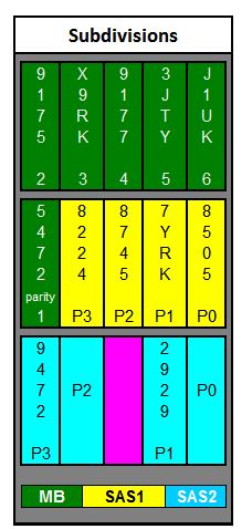

To see if the issue is with the physical slot in the middle 5 in 3 cage, I moved the brand new red balled disk to a different slot. It's the disk ending in 7YRK. I moved into second from the left, bottom row. Also a Supermicro cage, but a different one.
It's still red balled, but correctly labeled as disk 8 and sdl.
