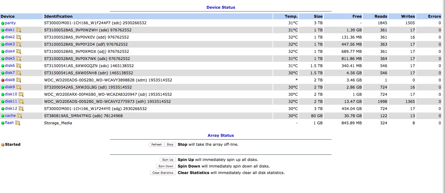

I've had a drive fail that I need to replace (disk11) in the screenshot. I've inserted the new disk and need to re-raid,
but I also have a disk (disk8) that is marked red, but has been available and working for some time. This has been like this for a little
while (disk8), and I've not fixed it before disk11 just died, it appears to be red because it can't get some temp info from the drive,
but reads/writes and other stats are just fine.
Is the array screwed now and cannot be rebuilt because I have 2 failed disks even though 8 is actually healthy? Before this disk11 failure the array was stopping/starting just fine even though disk8 was marked red due to just temperature info being missing. Or is there a way to tell disk8 to just be marked
healthy?
Attached is a screenshot. Thanks!!

Disk11 was being used along with the rest of the disks to allow you to use the content of disk8, the physical disk was not being used for as long as the red ball was there. Now that a second drive has failed, disk8 can no longer be emulated, and all data is gone. The physical drive that was linked to disk8 may or may not be healthy, but the contents of the physical drive are not valid to rebuild disk11.
If disk11 was dropped for cabling or power reasons, and the drive is actually still ok, you may be able to get the contents of both disk8 and disk11. If the physical drive that was attached to disk11 has completely failed, you will not be able to rebuild either disk.
Post a syslog and smart reports for all drives here for a more thorough analysis, but you are probably going to be stuck retrieving your data from your backups, I don't think the prognosis is good for disk8 or disk11.

???  WHY would you keep running with a red-balled (disabled) disk ??  The whole idea of the fault-tolerance you have in your array is that you can rebuild a failed disk as long as only ONE disk is bad.    Once you have a disabled disk, the VERY first thing you should do is resolve that problem => by perhaps confirming that it's not just a cabling or power issue and, if that's not the case, replacing the drive.
Clearly you've now learned this the hard way ... and now have two failed disks => neither one of which can be rebuilt.
Hopefully at least some of the data will be readable from the failed disks.
r.e. your questions:  The easiest thing to do is just do a New Config and assign ONLY the disk(s) you want to try and read.  You won't lose any data from the disks -- the only time they have to be cleared is if you're adding them to a parity-protected array.  When you're creating a new array it simply does a new parity sync to the assigned parity disk (if you have assigned one).

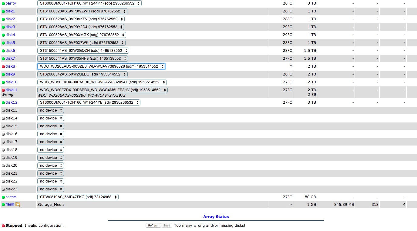

Plugging the old disk11 back into the array, I'm able to boot the array now and only disk8 is marked as bad.
I need to look into smartctl for both 8 and 11 and see if I can verify if 8 is working and then mark it is healthy and might be able to properly recreate this array.
If you do this successfully, parity will be invalid and need to be recalculated, and anything that was written to the emulated disk8 after it was red balled will be gone.
If you can currently read from the disk8 slot, I would copy anything irreplaceable now, before messing with it any more.
What is physically on the disk assigned to slot 8 IS NOT what is on the disk8 that you are currently seeing, if the slot is red balled.

A "redball" means the disk has been disabled by unRAID. As others have noted, it is being emulated. It was not disabled due to "temp info", but because a write to the drive failed. After that point, all reads and writes on the drive were emulated by the array, and as jonathanm notes in his most recent post, the actual drive 8 doesn't have any of those writes on it, they are only on the emulated drive.
Post a new screenshot showing the current situation. I think it would be a good idea to get SMART reports from all drives in the system, since it has been neglected, before proceeding with any attempt to backup or rebuild the emulated drive.
Attached is the current state of the array.
I can copy the data from disk8 to a new system so that it is backed up safely to a remote location first thing.
Also would a short smartctl test of all disks be appropriate for a first look?

Your current array LOOKS good except for the red-balled disk8.    As already noted, this means you are reading from an EMULATED disk 8 ... not from the actual disk.
You SHOULD be able to do a successful rebuild of the disk now ... but given that you've had issues with another disk, I'd err on the side of caution and copy EVERYTHING from disk8 to another system NOW.
Then you can try replacing the disk and doing a rebuild ... and if it works okay that's great -- but if not, you'll have a backup of the contents.
... and in the future, when a disk red-balls, resolve it immediately.  If you don't have time to address it; I'd shut down the array and not reboot it until you do.
