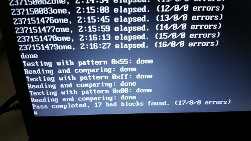

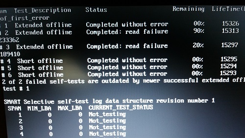

I've run into issues whereby a badblocks read of the entire disk (like a parity check) succeeds without a hint of issue and a smart long test catches an LBA that is causing trouble.
In fact, I ran into this about 3 days ago while testing a new drive.
Executed smart long test, READ ERROR flagged at LBA nnnnnn.
4 pass badblocks executed.
First pass reported bad blocks, next 3 passes succeeded without issue.
checked smart, sectors were reallocated.
Reran smart long test a new READ ERROR flagged at LBA oooooo (this one went much further into drive).
Re-ran badblocks 4 pass test, no errors reported.
Smart did not reveal any new pending sectors or additional sector reallocations.
Reran smart long test succeeded without error.

Anecdotal Evidence
Notice how the smart short tests did not reveal the problem.
With this case it's as the prior post.
smart short test
smart long test, Read failure.
4 pass badblocks.  pass 1 revealing problem, pass 2-4 did not reveal issue.
16 sectors reallocated at start, 30 sectors reallocated at end, no pending sectors.
Smart long test again, read failure in a different place.  No pending sectors. (this is what really surprised me)
4 pass badblocks, no errors reported, no sectors reallocated, no pending sectors.
smart long test passes.
What this reveals is that badlocks or preclear alone cannot detect or force the error to occur. Nor can a full badblocks read or parity check read.  It's probably more likely that a problem will be revealed with a full read, but in this case that did not happen until the smart long test occured.
It's crucial to do the smart long test before inserting the drive into your array or someone may be unpleasantly surprised.
