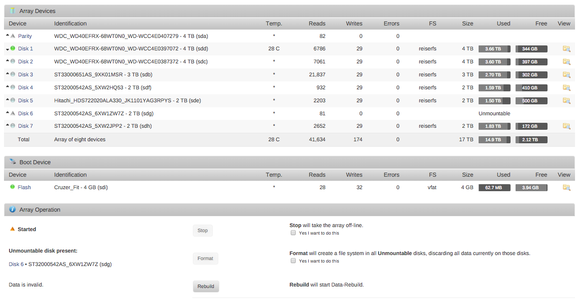

At this point one of my drives dropped out of the array and listed as unmountable.
Since then I reran a complete preclear on the drive hoping I could add it back and rebuild the data.
The preclear ran without errors but now I can't do anything.
If I try to format the drive the GUI does nothing for a couple of seconds and then reloads but nothing happens.
If I try to rebuild the data nothing happens.
I've attached a screen shot.
I'm guessing that my next step is to do a "new config" and loss the ability to rebuild the data.
Anyone have any other suggestions?

I agree.  It's unclear to me how I got here.  Nothing I did should have caused this issue but...
At this stage the drive has been completely wiped by the preclear.  I just want to get it back into the array and hopefully rebuild the data from the parity which should still be OK from the 5.x build.
I've attached the results from running Tools/Diagnostics.

nope.  I've had no success at all.
I'm trying to run the reiserfsck utility right now.
