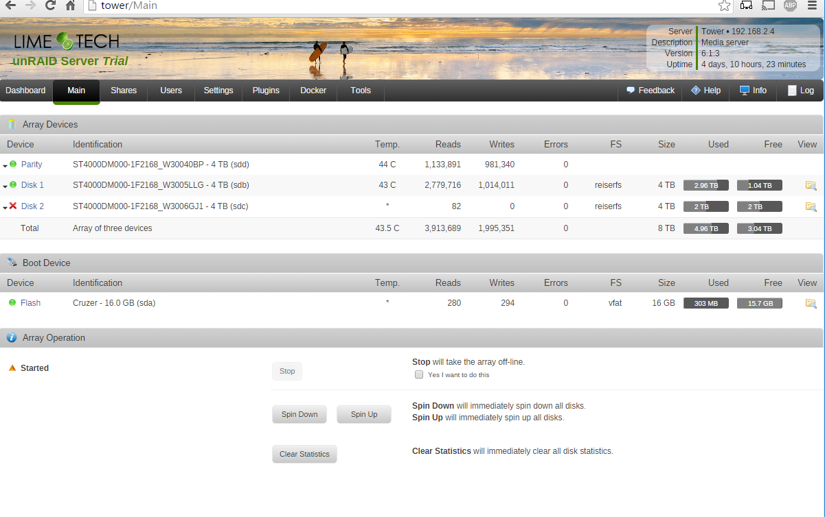

You absolutely can NOT do a parity check -- 'nor do you want to.    At this point the parity drive plus disk #1 have all the information needed to be able to emulate disk #2 and to rebuild it onto a new drive.
Parity is shown as good ... hopefully that's accurate (when did you do the last check??).    As long as it is indeed good, you can rebuild disk #2 and all of the data will still be fine.    Hopefully you just have a loose cable or connection ... if that's the case after you fix it you'll be able to rebuild the contents back onto the same drive.  If not, you'll need to replace the drive and then do a rebuild onto the new drive.

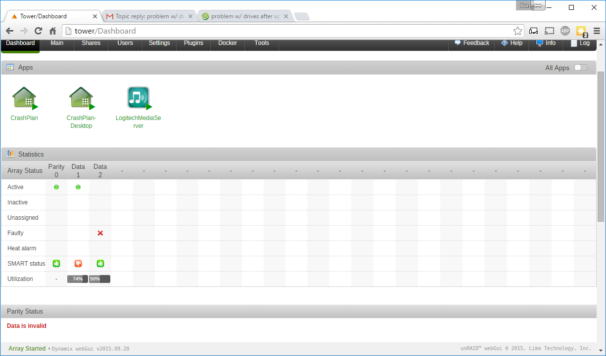

The syslog in the diagnostic is too recent to have captured the event. Has anything changed since the screenshot? Probably the disk has been disabled and is being emulated. It has very bad SMART and should be replaced by rebuilding to another disk.
The only things that have changed is that I've purchased the key, and rebooted the server....
Why would the drive the works have bad SMART and the drive that is dead has good SMART?  So I'd need 2 new drives--what's the safest way to rebuild everything?

Don't understand what you mean. Your screenshot only shows parity, disk1, and disk2. None of them are dead. Disk2 has been disabled by unRAID because it is unreliable. Disk2 is the one that should be replaced.
Can you read the disk2 data? If so that is a good sign. It means the array can recover the disk2 data so it can be rebuilt to a new drive.
What has happened is disk2 is failing as indicated by its SMART report in the diagnostics. When unRAID attempted to write to disk2 the write failed. When that happens, unRAID disables the drive and WILL NOT USE that drive slot again until it is rebuilt. Instead of actually using that disk, unRAID emulates it. When it needs to read the drive, unRAID reads all of the other data drives plus parity and calculates the data for that disk instead of actually reading the disabled drive. When it needs to write the drive, unRAID reads all of the other data drives plus parity, calculates what change would happen to parity as a result of the data change, and writes parity instead of actually writing the disabled drive.

Right--I understand that..but when I look at the 'dashboard', it shows the SMART status for the parity drive and data 2 to be good...but data 2 is faulty...

In Disk Settings you can see what attributes are monitored. If you click on a disk from Main it will let you look at its attributes.
From your diagnostics:
Disk1 is not perfect
Serial Number:    W3005LLG
  5 Reallocated_Sector_Ct   0x0033   100   100   010    Pre-fail  Always       -       8
187 Reported_Uncorrect      0x0032   098   098   000    Old_age   Always       -       2
197 Current_Pending_Sector  0x0012   100   100   000    Old_age   Always       -       0
198 Offline_Uncorrectable   0x0010   100   100   000    Old_age   Offline      -       0
But not nearly as bad as disk2
Serial Number:    W3006GJ1
  5 Reallocated_Sector_Ct   0x0033   093   093   010    Pre-fail  Always       -       8752
187 Reported_Uncorrect      0x0032   001   001   000    Old_age   Always       -       145
197 Current_Pending_Sector  0x0012   001   001   000    Old_age   Always       -       55976
198 Offline_Uncorrectable   0x0010   001   001   000    Old_age   Offline      -       55976
Probably the dashboard should be giving a thumbs down on disk2 also but maybe it isn't really checking it anymore since it's disabled.
The "thumbs down" symbol for disk 1 doesn't mean it's bad ... just that there are some attributes that bear watching.  In this case, the reallocated sectors.
Your real issue -- as noted above -- is that disk #2 is disabled, so THAT needs to be resolved (by replacing the disk and letting the data rebuild).    AFTER that is completed, if you want to also replace disk #1 that's fine ... but the reality is that 8 reallocated sectors isn't a bad count with modern drives ... the key thing is to watch that and see if the number changes (increases) => if so, I'd replace the drive before it becomes a problem.
