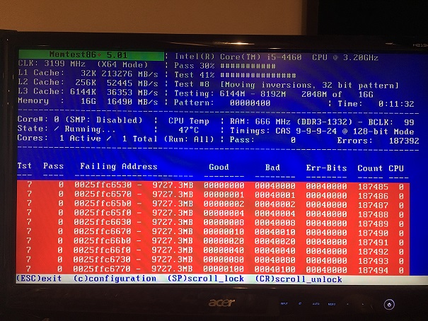

Have you tried running memtest? Having the system pass 24 hours of that would eliminate the ram from being an issue.
Thanks buxton, you are correct: I had already started running Memtest after a hard restart and I can't say for sure, but to me this doesn't look good.
The RAM is this, purchased in July:
http://www.newegg.com/Product/Product.aspx?Item=N82E16820233536
I noticed the timings on the screen don't match the specs on the RAM. RAM is 9-10-9-27 @ 933 MHz, but my system was running it at 9-9-9-24 @ 666 MHz! I assumed the mobo would detect and automatically assign the correct settings (ASRock Z97 Extreme6, DRAM timings were all "Auto")... I certainly didn't intend to run my RAM out of spec!
I manually reset the timings and clock speed, ran another memtest with both sticks, and still got a ton of failures. I tested each stick individually and narrowed it down to one bad stick. I ruled out mobo issues by testing each stick in a couple slots. Bad stick failed everywhere, good stick nowhere.
I assume it's ok to hobble the system along on one stick until I can replace it, correct?
...but to me this doesn't look good.
Correct, a single error is not good.
You were running them at SPD speed, which is bellow maximum speed, so no problem, usually need to select XMP profile in Bios to use maximum rated speed.
Yes, but looking at your syslog there are some signs of corruption on your docker image, maybe a good idea to recreate it.

Is there a known issue that btrfs is especially susceptible to corruption when there's bad RAM in the system? I ask because through all of the crashes and surprise reboots, my reiserfs data/parity drives had no problems, and I'm not seeing any issues with my newly XFS-formatted cache drive. However, when the issue first occurred it completely wiped my btrfs cache pool, and now there's an issue in my Docker image (which I believe is also btrfs, right?).
I agree that the speed on the RAM was underclocked, but the timings seemed aggressive. Or maybe just bad luck fried the RAM. Either way, I'm ordering two more sticks of the same so I can have a spare on hand if the other goes down.
Timings decrease as frequency increases, those kind of Dimms usually have two sets of timings, for the model you're using they are:
SPD 9-9-9-24@1333Mhz (this setting is generally used with bios set to auto)
XMP 9-10-9-27@1866Mhz (to use this one you have to set xmp profile in bios)
Both should work reliably and for Unraid use (and most other uses) performance will be similar.
This is just a guess, but the fact that Btfrs uses real time checksums probably makes it more susceptible to memory errors.
