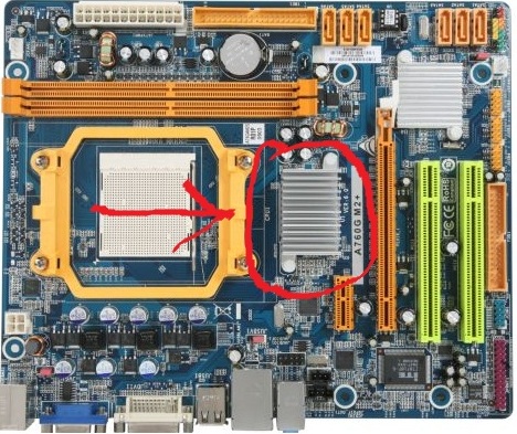

Also, I noticed that the northbridge heat sink is between very warm and hot (more like hot) to the touch.  Is this normal for this mobo?
EDIT:  I managed to figure out the flashing issues.  The F12 Bio-Flasher wouldn't work with the very latest bios (A76GM714.BSS) but it did find and load (A76GM728.BSS) which has the AMD Sargas 140 support in it.
Immediately after flashing the bios my cpu was recognized.  Just copy the A76GM728.BSS bios file onto a thumb drive and press F12 when booting to flash the bios.
I've got a concern about the Northbridge heatsink getting very hot on my motherboard.
If you have this mobo can you check if the heatsink circled in the picture gets hot?
Thanks
Do you mean just hot to the touch, or do you have some diagnostic program in mind?
Hot to the touch.  I'm looking for a probe to check the temp but it's Hot!
OK.  I'm fairly sure I still have a A706G laying around somewhere, and I've been planning on building a computer from all my spare parts anyway.  I'll fire it up and see what I get.  I don't use it as my server mobo anymore, I'm afraid.
Wait, the heat problem just got solved.  I just upgraded the bios to the latest A76GM714.BSS and afterwards the chipset is now room temperature.  Wow, what a difference.  I was on bios A76GM728.BSS before.
Thanks for offering to help.  You contribute so much to this forum that I just want to you to know it's appreciated very much.
My pleasure.  Good to know about the BIOS update.  I don't think I've updated mine since I got it.
