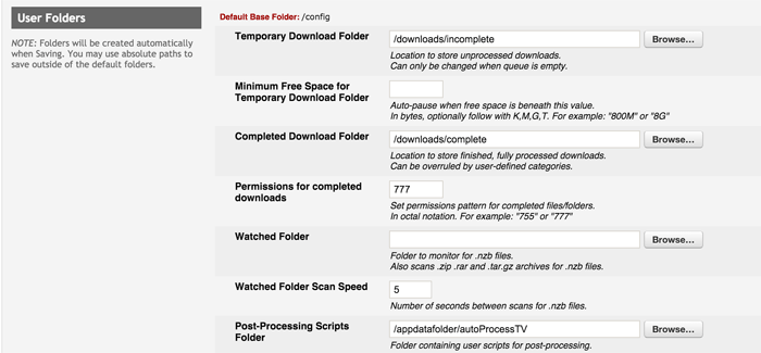

yes will be a docker issue for example SABnzdb has a setting under config/folders for permissions for completed downloads. Set it to 777
see attached pic
Thank you!  That was it.  SAB was missing that permissions setting!  I must have missed it when I set it all up manually for the docker!
