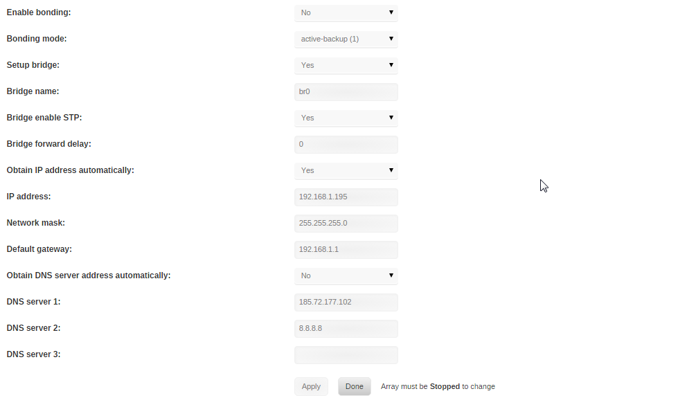

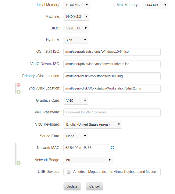

One problem, network. Windows 10 does not register any Ethernet connections, is there a fix to this issue?
Attached below is my settings.

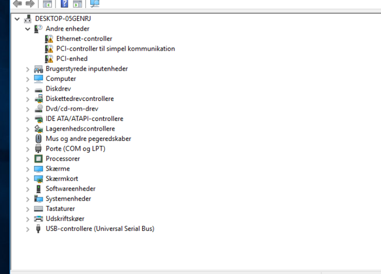

What do you see in Windows Device Manager?

Attached
QEMU_Workstation_-_noVNC_-_Google_Chrome_2016-01-16_02-19-28.png.3875a6473da463b2c6a3e925f5f4515c.png
I don't think you have drivers installed......
I installed it when installing, so I could see the vdisk. Did I miss something here?
Install the NETWORK drivers...
