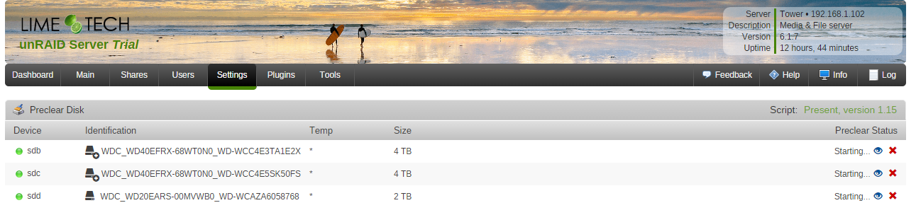

Problems:
Preclear Disk page shows all three drives staying in 'Starting' for more than 12 hours. Please see attached screenshot.
Clicking on the preview give the following log. Between all three, only the device name is different:
/boot/config/plugins/preclear.disk/preclear_disk.sh  -c 1 /dev/sdb
root@Tower:/usr/local/emhttp# /boot/config/plugins/preclear.disk/preclear_disk.sh  -c 1 /dev/sdb
grep: /boot/config/disk.cfg: No such file or directory
/boot/config/plugins/preclear.disk/preclear_disk.sh: line 1268: /boot/config/disk.cfg: No such file or directory
I've also attached the syslog generated from the diagnostics page.
Please help! Is there something else I need to do in order for the disk.cfg file to be created?
Thanks a lot.

The plugin expects there to be a disk.cfg file.    This is normally created the first time you start the array.  I believe that it is also created if you do Tools->New Config.

Do not forget that preclear is not a core part of unRAID but a 3rd party add-on, so it tends to assume that you have at least created an initial array.  If/when preclear gets incorporated into the unRAID core functionality then this issue would probably be addressed.

It likely looks and requires that file to make sure someone doesn't nuke a disk that's in the array.

I believe that it is checked to make sure that you are not accidentally trying to preclear a disk that is already assigned to the array as a data disk.

Thanks again. That's logical and makes sense. I did 'new config' but there was no disk.cfg file. I added the disks to the array, and sure the 'disk.cfg' was created. I run Preclear and got the "sorry can't preclear as the disk is part of the array" message.
I did 'new config' again. disk.cfg was still intact in the expected folder. I started Preclean and it worked this time.
Happy camper now, but had I not waited, I'd have saved quite a bit of time.
