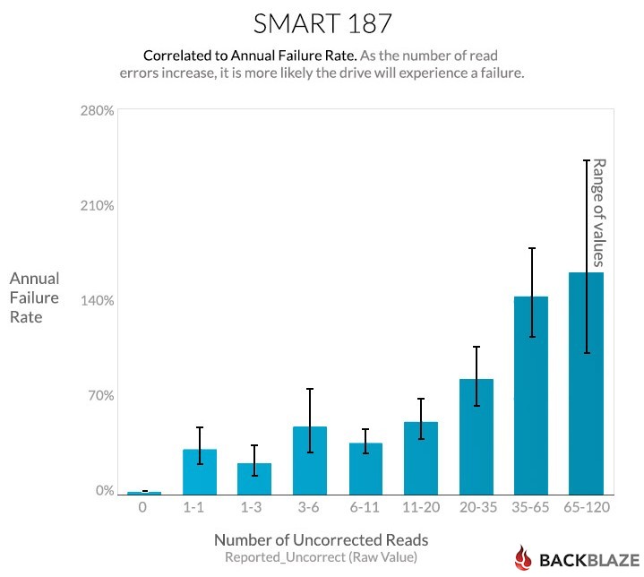

I'm trying to track down a smart error on a less than year old Seagate ST5000DM000 5TB drive which is my Partity Drive.  SMART Log attached.  I'm seeing several things that I'd like to know if are important or not:
1. In the dashboard, I see a warning which takes me to disk attributes.  I see "Reported Incorrect" at 13 raw value indicating there have been 13 incorrect sectors?  Should I worry about this?
2. I was looking at unMenu Smart View to see if it shows anything interesting.  It did indicate "HPA?" (see image).  When I hover over HPA? I see "Warning: Detected non-standard drive size - may contain an HPA.  Set drive hpa_ok attribute to 1 to ignore"

According to blackblaze anything above 0 it’s not good news and there’s a much higher probability of failure in the near future, I’ve no personal experience with that attribute, and I’ve seen many here on the forum with higher values, maybe monitor value and keep a spare handy.

@johnnie.black, great find.  FYI for any others out there looking, you can find the Smart Statistics johnnie showed at https://www.backblaze.com/blog/hard-drive-smart-stats/
