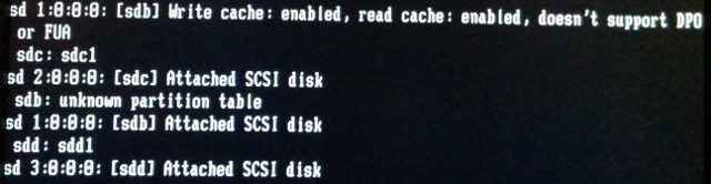

[*]I replaced my parity drive (sdb I believe) and tried to boot it up, but it would not boot.  It would get to the UnRAID boot menu (normal, safemode, memtest).  If I selected either normal or safe mode it would start to load the "bzimage" and would get through all of the loading dots but when it finally said "ready" it never continued in the boot sequence and just got stuck.
[*]I tried to transfer my flash drive to another flash drive, but it didn't work (I didn't pursue this any further so this could still be an option for me).  So I tried plugging in the original flash drive one more time and this time I got to the UnRAID boot menu, selected safe mode and this time it got past the "ready" screen and continued to load.
[*]It loads until it gets to the part of the startup sequence where it is looking at the HDDs.  I'll upload a screenshot in the next post.
[*]I turned it off and on a few times, but it never gets past this part of the startup sequence

I couldn't post the entire screenshot (forum restrictions to file size) but these are the last few lines...
Hold it.... I let it sit at that "stuck" screen for a long time and eventually it booted!  I'm now running a parity sync.  I'll let you know if anything goes bad.  If the worst comes I have everything backed up to CrashPlan.
The parity sync worked, all drives are green.  I was in safe mode so I rebooted to normal mode and it did get stuck at the same spot, but it eventually got through.  When it does eventually get to the "Tower login:", instead of just waiting there at that prompt, it then shows a message:
