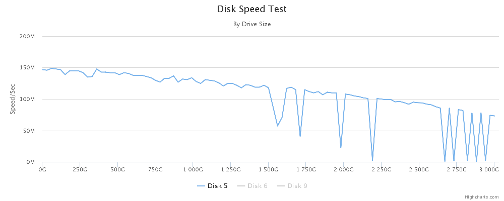

You can run diskspeed to look for slow sectors on your disks:
diskspeed.sh -s 101
This will take some time, about 15 min. per disk, don’t use the array during the test or it will skew results, this is not a complete disk test, but in my experience it’s sufficient to detect slow sectors, like the example below.
