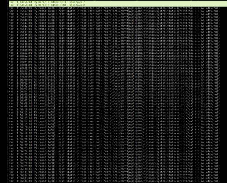

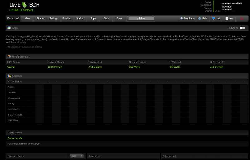

I let the server sit and come back after some time to see nothing coming up but script errors.
It looks like the dynamix stats script fails out and then everything follows?  Have a look at the log and screenshots.

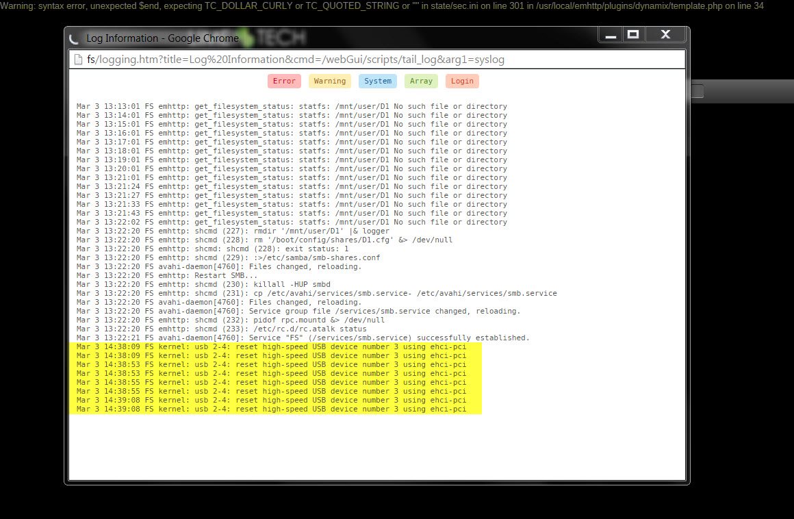

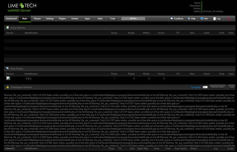

It did it right in front of me so I got a look at the log.  From the attached, it looks the like server is resetting the USB.  A quick attempt to access the USB via the network shows that it in fact is dismounted, hence all the plugins trying perhaps to permanently log things to the flash and failing...so I would assume.
Next question - is this a symptom of failing hardware/usb port or the usb drive itself coming to an end?  It is the original one that I have been using since day one...perhaps 6 years now.
I will pull it and try another USB port.  If it goes away, then I guess the port is wonky.  Further fails and I guess we can move the key over to a new USB stick and see what that does?  If still, then perhaps my MB is slowly fading away...
