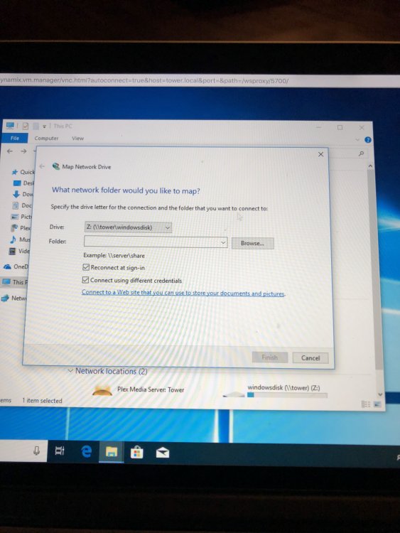

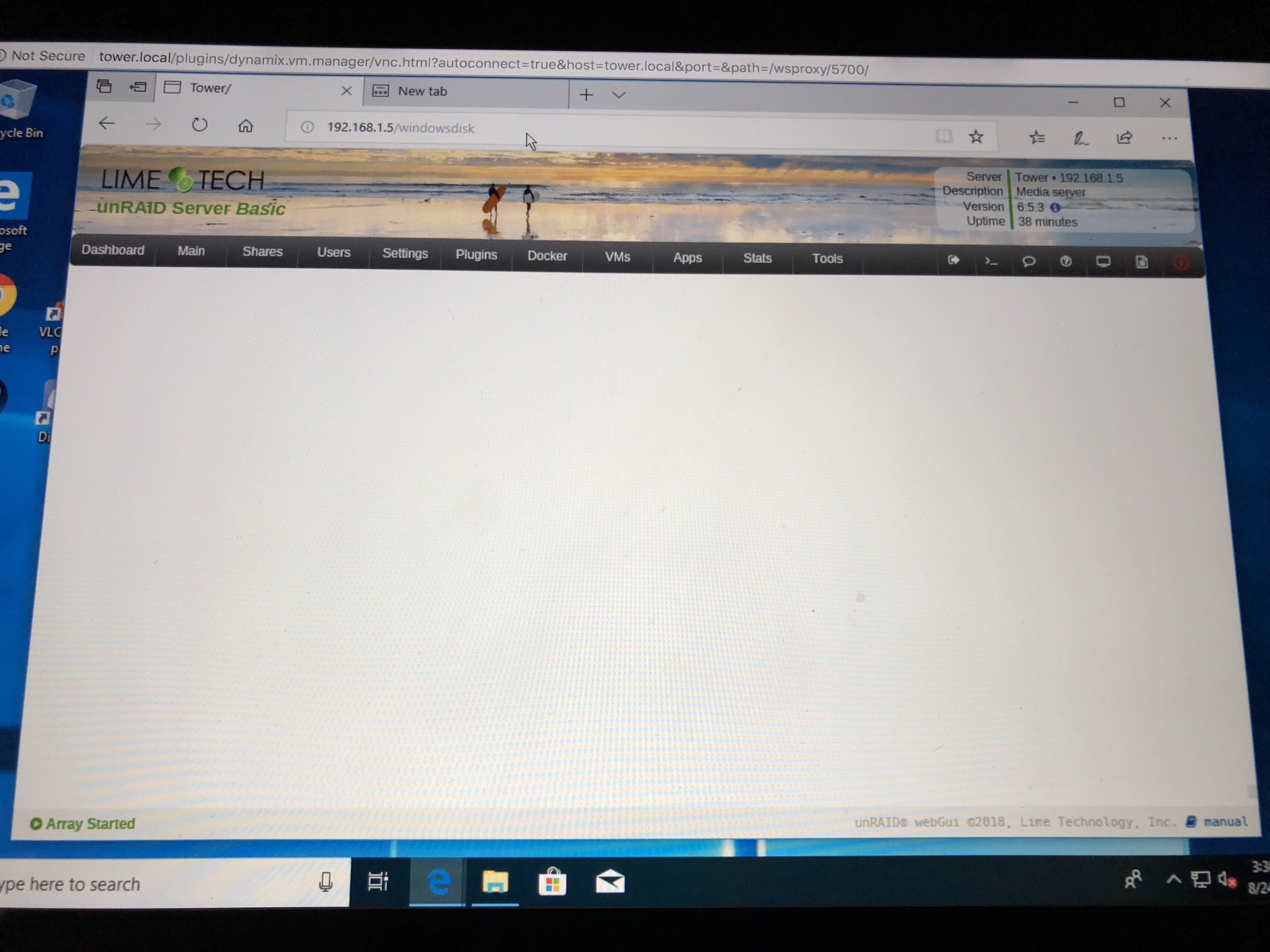

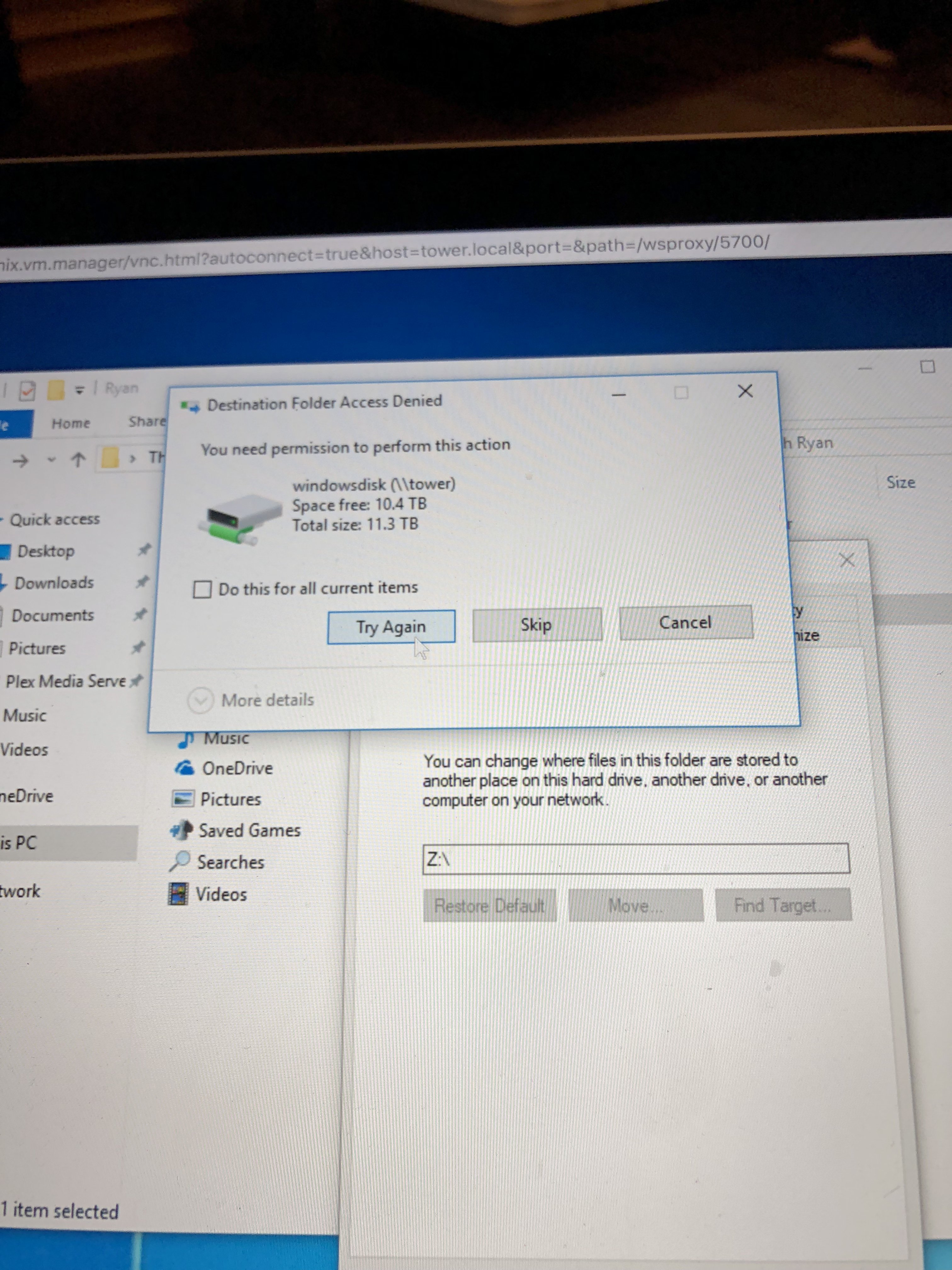

Hi I am having this issue as well.  I have the necessary share set to export and it still fails to so in the windows 10 vm.  I have followed what this thread states but can't figure it out. Please help
map a new network drive in explorer and type in //unraidtowerIPaddress/(name of share folder)
\\unraidtowerIPaddress\(name of share folder)
This is what I got when I typed that in.
file explorer.
this PC

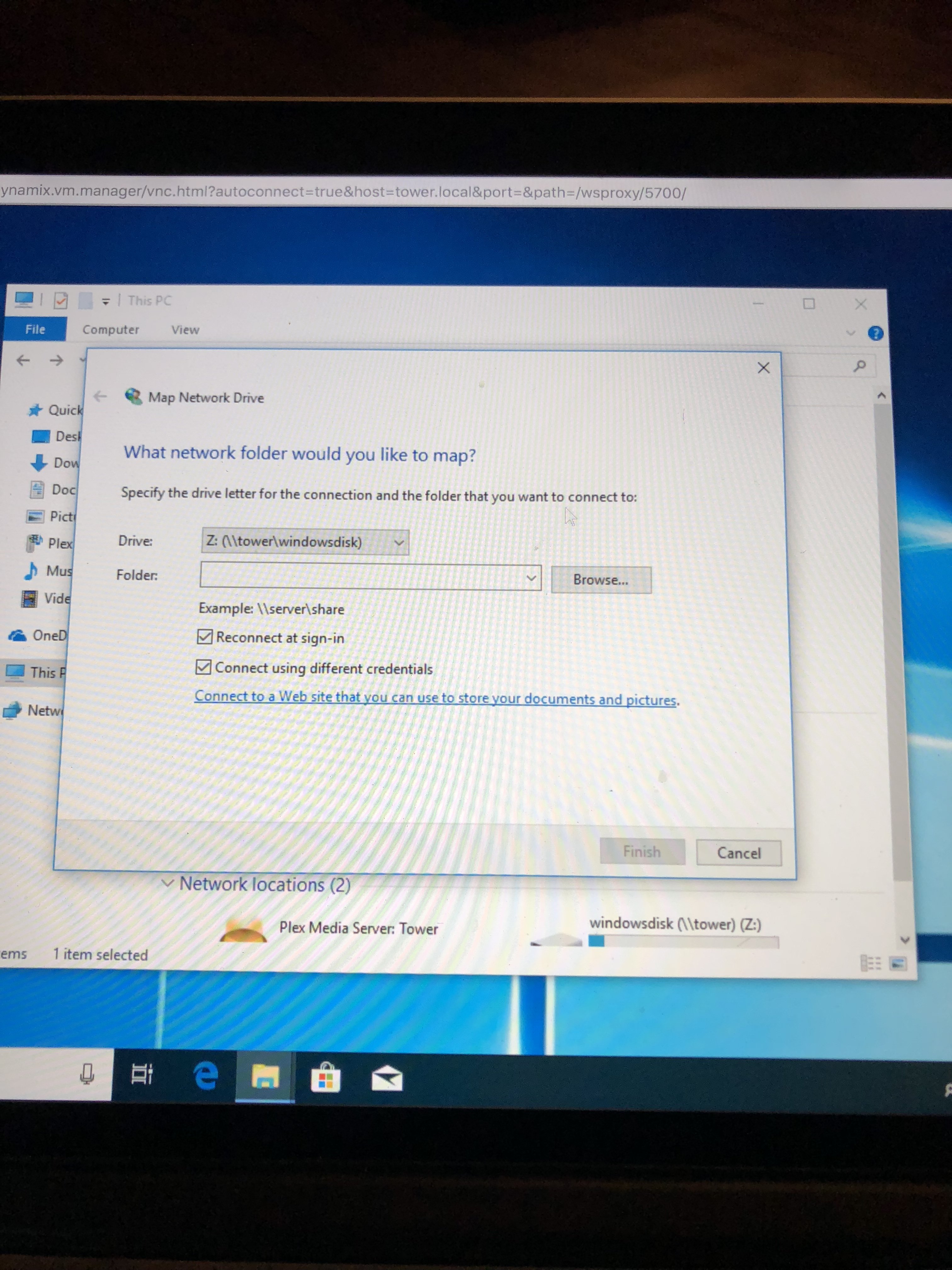

Click on Computer tab
Map network drive

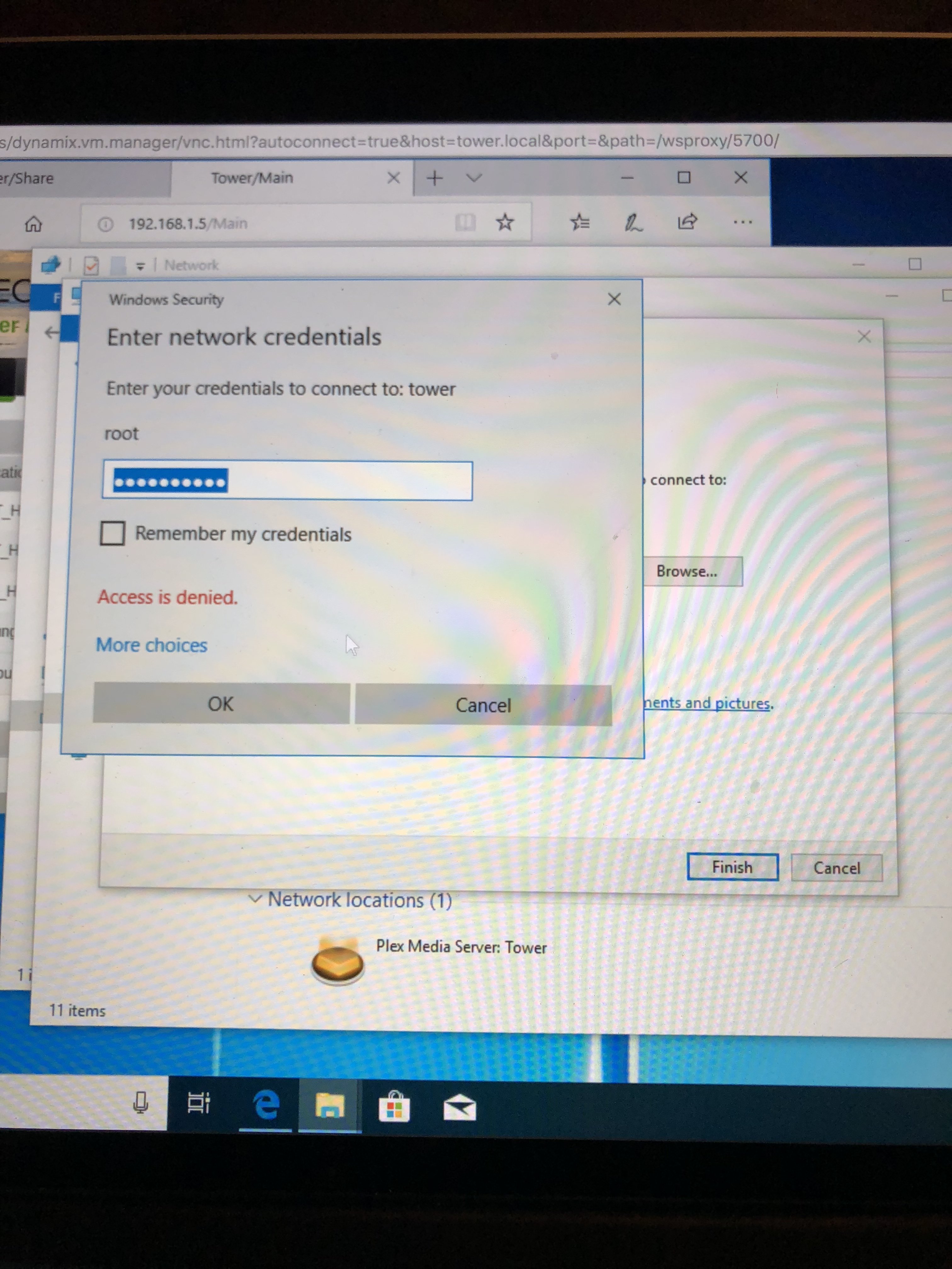

I keep getting access denied when trying to login
Edited by scufless
User root is not allowed access to user shares.
I had to create a new user to successfully login but this is where I got to
