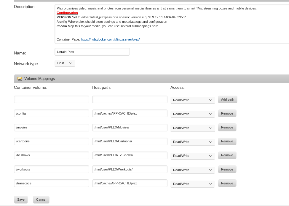

here is the pathing I chose during  setup
Do you have a share named APP-CACHE? Is it cache-only?
Do you have a share named PLEX?
Note that the names must match exactly including upper/lower case.
yes to all
