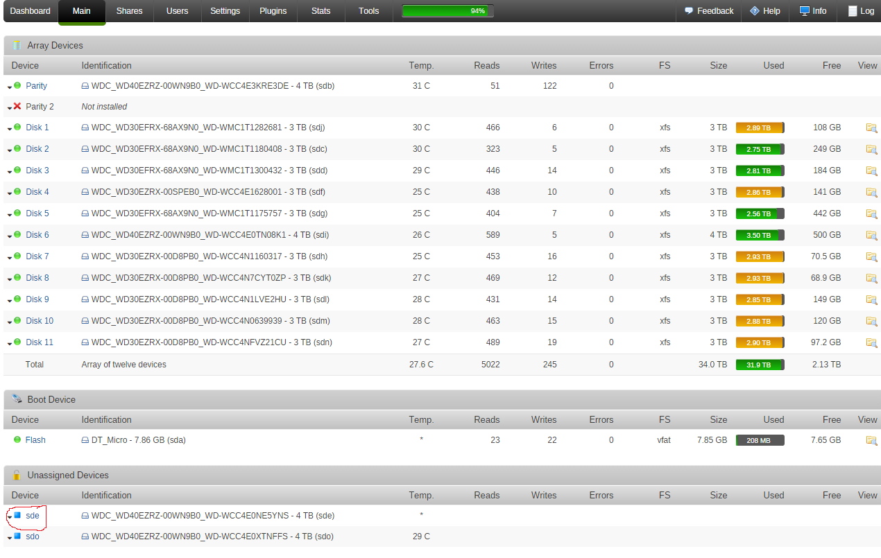

Just installed two new WD Blue 4TB, was about to preclear them, one is for parity2 and other for array expansion, but one of them comes with SMART disable, this is the first time I have this issue, swapped cable/sata port with other disk and issue remains, I can turn it on using smartctl but after a reboot it’s off again, any ideas?

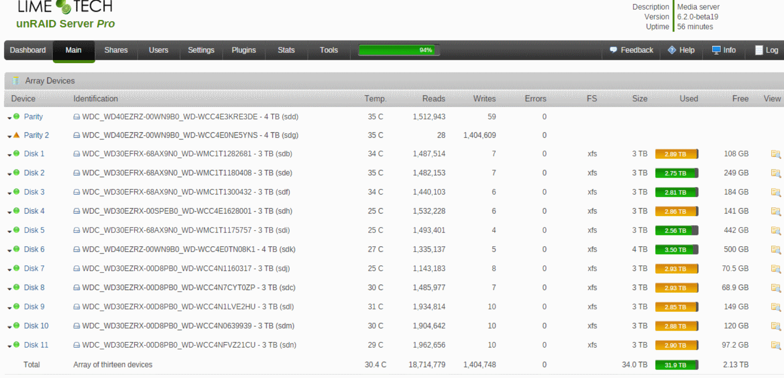

Well, power cycling didn’t help but as soon as I assign it SMART started working, so as long as it works when assigned I’m happy.  :)
