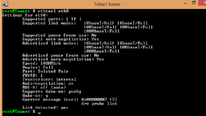

I have run run ethtool eth0, with the attached results
This reports drv probe link?
I am using standard Intel gigabit NIC

Dropped packets are NOT a problem in 99.99% of all cases.    I have two Intel NIC's in my servers because of real operational issues with the on-board RealTek NIC's.  Both of them have dropped packets on the receive side.  (134,863,506 drops in about 28 days on my Media Server!  Most of them occur when streaming BluRay ISO's to my Netgear media players.) Unless, you have another identifiable issue that is causing an operational problem, I wouldn't be worried.
If you google dropped packets, you will find that most of the time, there is no solution and the 'problem' is usually a non-event.
Squid, when you get a chance please can you have a look at my test results
0.14% dropped packets.  (Or, in other words 99.85% of packets were not dropped)
I think that if I was in school and got 99.85% on a test I'd be pretty satisfied.
