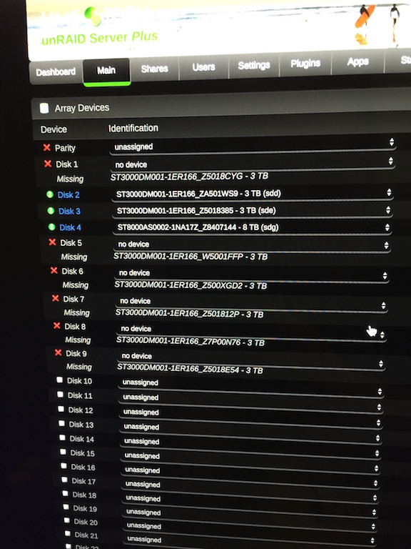

Not really looking for any answers here, but just venting. I just finished a few months ago a rebuild of my Unraid server in a bigger case with a better (or so I thought) PSU (http://www.newegg.com/Product/Product.aspx?Item=N82E16817438035) and more drives. Everything was working well until about a week ago, when my server suddenly died in the middle of the night and wouldn't power back on. Troubleshooting determined the PSU had failed, so I RMA'd it.
Tonight I got the replacement PSU and threw it in. Everything powered back up fine, but attached is the mess that I found in unraid once it booted. That's 7 failed drives. I've swapped everything relevant and the drives are indeed dead. I've submitted a reply to my support ticket with EVGA but I doubt they will cover anything else that was damaged. Seagate won't RMA the drives due to the damage being caused by the PSU.

Since the platters and heads are likely fine, repairing those drives should be relatively inexpensive. A circuit board swap (with eeprom reprogramming) should be all that is necessary.
http://www.donordrives.com/services is one place that offers that service (no affiliation, but I've used their services and was very satisfied.)

I had some important files backed up like configs but the data itself was just to large to practically backup. Server was behind a tripp lite PDU and cyberpower UPS. I do not suspect a power surge as no other equipment behind the same UPS had any issues or downtime.
EVGA just replied to my support ticket that they will not do anything about any products damaged by their product's failure. I wasn't expecting them to, but it would have been great customer service if they would have.
Not sure if I'm going to try and RMA any drives, seems like a gamble.
