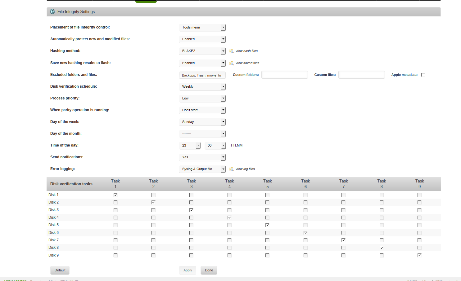

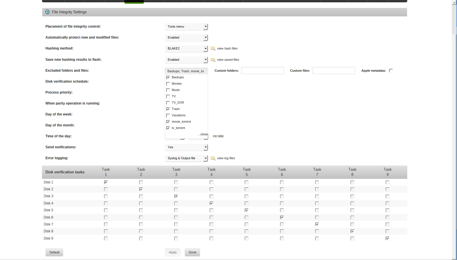

Can you post a screen capture of your settings page. Somehow the settings are not translated properly and results in a wrong command execution.
Here you go - remember, the bigger issue is why it won't let me stop the array  :(
I created the exact same share names as you have, and set the exact same settings as you use, but can not reproduce your issue (in my case all works as expected).
To be more precise; in your case the folder references for the exclude string in inotifywait are not properly formatted.
In your diagnostics I see the following (wrong):
inotifywait -mrqe close_write --exclude ^/mnt/disk[0-9]+/[color=red]Backups|Trash,movie_torrent,tv_torrent[/color] --format %w%f /mnt/disk1...
While in my situation I see (correct):
inotifywait -mrqe close_write --exclude ^/mnt/disk[0-9]+/[color=blue](Backups/|Trash/|movie_torrent/|tv_torrent/)[/color] --format %w%f /mnt/disk1...
