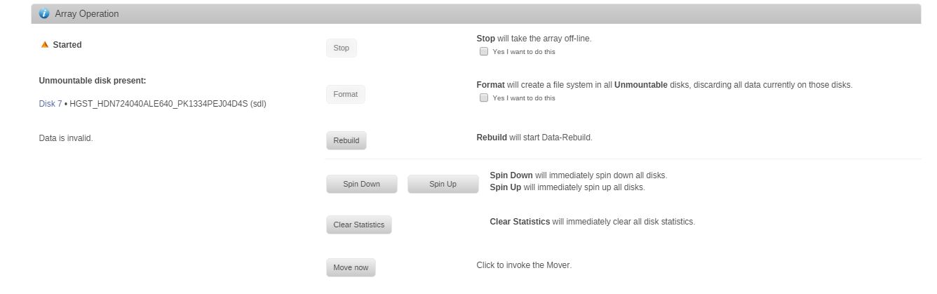

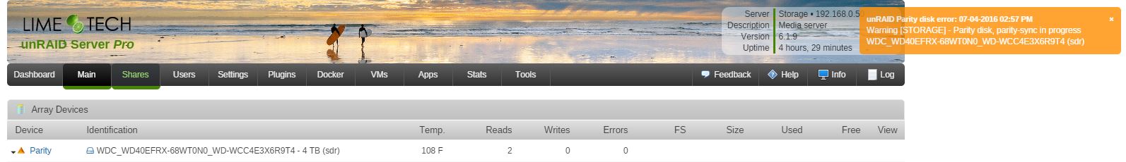

I stopped the array, removed the parity drive, started in maintenance mode, stopped the array, re-added the parity drive and started it back up. I got a message stating that a parity-sync had started but nowhere on the main page does it say anything about the parity sync or anything like that. I have attached a screenshot.
Added a syslog
EDIT: Now the Parity disk is spun down so it obviously is not doing anything
