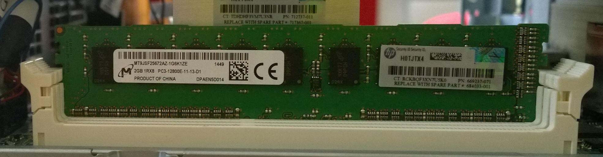

I took a photo of the current 2GB RAM module. It appears to be PC-12800.  Is that a problem with matching?  Would this be better?

Pic of the current module attached.
With a Celeron you can buy 1333 or 1600, it will always work @ 1333.
ok, thanks for the confirmation.  So I can save a few $$$ and go for the cheaper 1333 stuff.
What exactly does this number refer to then? PC-12800.
Thanks.
pc3-12800=1600Mhz
pc3-10600=1333Mhz
Different ways of classifying memory, first is by the peak transfer rate, second is by frequency.
