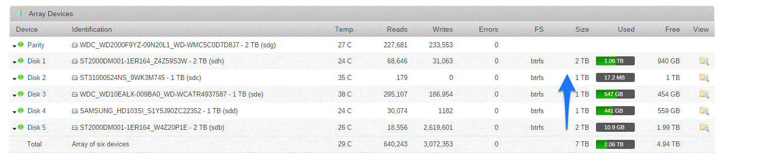

I'd like to swap the position of 2 disks; Disk 5 and Disk 3, and I want to retain the data that is currently located on each disks position.
Disk 3 is setup to include all my photos and artwork, Disk 5 has only minor files and such. As Disk 5 is larger and more appropriately sized for what I want to do with my photos I'd like to swap them so the 2Tb drive becomes Disk 3 and will house my photos, and Disk 3 will become Disk 5 and contain all the minor files and such.

Yes, I based my response on the screenshot posted, using single parity.
