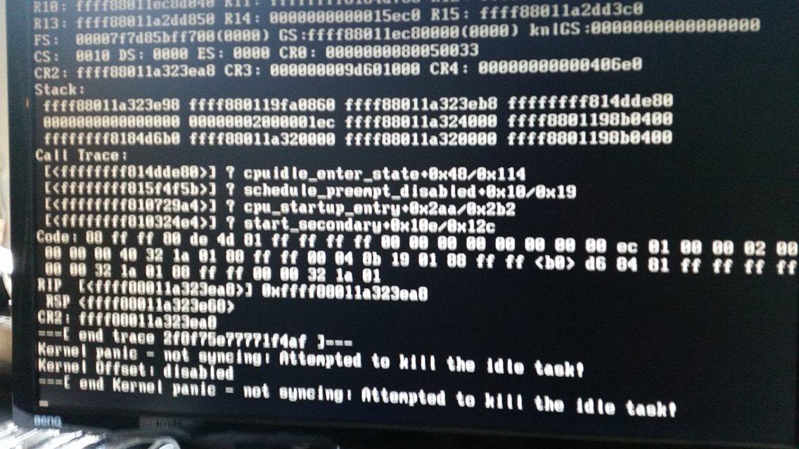

unRaid going unresponsive after10mins
Hello, as the topic says my unraid system and plex server won't respond after about 10 minutes online,
I have resetted router
Changed TP cable
unraid webgui and plex media server goes unresponsive, and abit later the shares go down to
syslog included
syslog.txt
What are your complete hardware specs on the server including PS make and model
The syslog is way too short to be of any use.  What you need to do is reboot the server, install fix common problems, and then put it into troubleshooting mode.
After the system crashes, then post from your flash drive folder logs the latest diagnostics files, and the syslog.txt file

Not sure why, but your log is filling up so quickly with just repeats of this section:
Jun 12 20:58:36 SkyNAS kernel: Call Trace:
Jun 12 20:58:36 SkyNAS kernel: [<ffffffff815f2403>] dump_stack+0x65/0x85
Jun 12 20:58:36 SkyNAS kernel: [<ffffffff815ee38a>] __schedule_bug+0x46/0x54
Jun 12 20:58:36 SkyNAS kernel: [<ffffffff815f462c>] __schedule+0x66/0x6d6
Jun 12 20:58:36 SkyNAS kernel: [<ffffffff815f4d0c>] schedule+0x70/0x7f
Jun 12 20:58:36 SkyNAS kernel: [<ffffffff815f4f5b>] schedule_preempt_disabled+0x10/0x19
Jun 12 20:58:36 SkyNAS kernel: [<ffffffff810729a4>] cpu_startup_entry+0x2aa/0x2b2
Jun 12 20:58:36 SkyNAS kernel: [<ffffffff810324e4>] start_secondary+0x10e/0x12c
Jun 12 20:58:36 SkyNAS kernel: BUG: scheduling while atomic: swapper/1/0/0x00000002
Jun 12 20:58:36 SkyNAS kernel: Modules linked in: kvm_amd kvm xt_CHECKSUM iptable_mangle ipt_MASQUERADE nf_nat_masquerade_ipv4 iptable_nat nf_nat_ipv4 nf_nat nf_conntrack_ipv4 ipt_REJECT nf_reject_ipv4 ebtable_filter ebtables iptable_filter ip_tables tun md_mod fam15h_power r8169 mii i2c_piix4 k10temp ahci libahci acpi_cpufreq [last unloaded: kvm]
Jun 12 20:58:36 SkyNAS kernel: CPU: 1 PID: 0 Comm: swapper/1 Tainted: G        W       4.1.18-unRAID #1
Jun 12 20:58:36 SkyNAS kernel: Hardware name: System manufacturer System Product Name/A88X-PLUS, BIOS 1102 12/30/2013
Jun 12 20:58:36 SkyNAS kernel: 0000000000000001 ffff88011a323e48 ffffffff815f2403 ffffffff8182e140
Jun 12 20:58:36 SkyNAS kernel: 0000000000000296 0000000000000001 ffff88011ec95ec0 ffff88011a323e58
Jun 12 20:58:36 SkyNAS kernel: ffffffff815ee38a ffff88011a323ea8 ffffffff815f462c ffff88011a323e98
The amount of entries for this all with the same timestamp in the section you last posted easily explain why your log file is so big and I suspect it has something to do with why your server is crashing.

And that makes sense.  With a quick scan of the syslog with my first coffee, it looks like everything was fine up until the point that Plex started doing its thing  (Final entry shows that it was running @101% of the CPU (previous entry showed ~60%, and the prior ones were all 1%)
@CHBMB - I realize I didn't mention it  at first, sorry about that.Ofc its relevant, but thats me thinking you know :P
The temprature seemed to be ok, but it was dropping before I reached BIOS.
@Squid - I checked and it was on ASUS Optimal, is that the reason it goes above 100%?
My previous CPU (AMD A4-6320) almost used 100% when someone was watching Plex, now my (AMD A10-7890K Black Edition, Socket-FM2+) don't use as much when someone is watching plex on my server. So I don't know why it went 101% as I've disabled remote access for the time being.
Can you think of any reason? Is it bcus it was ASUS Optimal?
I've restarted with Normal Settings, and hope it doesn't overload.

Don't know about the 101%  (doesn't make alot of sense to me, but I'd have to investigate)  But the kernel panic happening while Plex is running full bore implies CPU overheating.  (I know that my A8-6600K's stock cooler was pathetic when used in a "normal" case and just not up to doing the job of cooling the system down)
FM2 coolers support FM2+? Would it be enough to get a new cooler? Or is something else entirely wrong as it reaches 101%?
I used the stock cooler for my amd 10-6980k cpu
Also trying to see if it is enough to turn to normal mode, will post update
Maybe install Dynamix System temp, then start a Plex transcode or two and watch the temperatures on the bottom of the webUI
