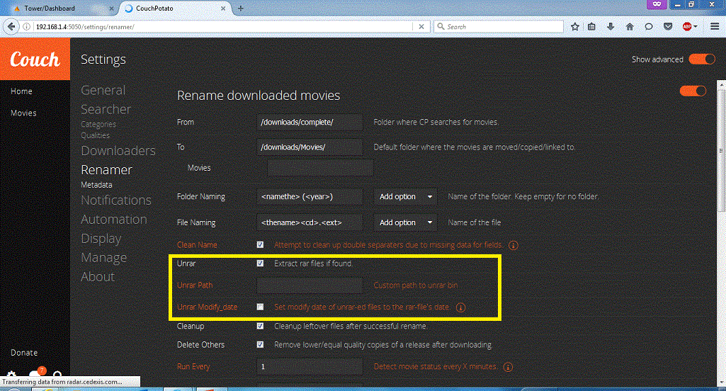

You are correct it doesn't download anything however when cp goes to rename the file it has the option to extract before renaming, you will find this in settings/rename.

So just had a look at my settings and there is a setting to extract if rar file found but I think this would be used if you add a managed folder with rar files within it.
If you go into advance view you can and unrar location. I have attached a screenshot.
