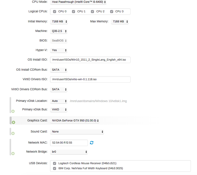

Attached is my current VM configuration. I have tried with both BIOS types and both Q35-2.5 and i440fx-1.4 and both do not work.
I hear the GPU starting up when I launch the VM and the screen goes from the typical prompt screen to full black.
Any help would be much appreciated. I am wondering if its the card that isn't compatible or if I am doing anything wrong.
Here is my XML:

Set the onboard graphics to be default. That way unraid uses that GPU for the console and you are free to use the nvidia card.
Thanks saarg. Do you mean set the onboard graphics to default on the BIOS settings of the motherboard or as the primary GPU and NVIDIA as secondary in the VM settings?
In the BIOS  :)
Thanks Saarg. You were right, that worked. I had to not only turn on the Intel Graphics but also set it to default vs 'auto' which seemed to make the PCIe card be the default.
