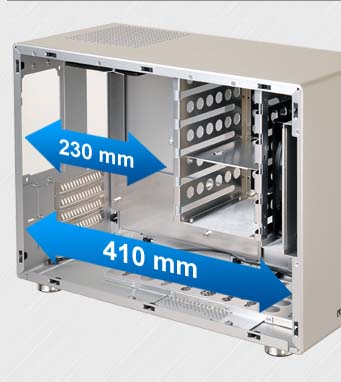

It's true that there is as much room between the ATX unit and the drive cage in an M25 as there is between the SFX unit and the drive cage in a Q25B; but there's certainly more room overall with an SFX unit, regardless of the case.
As you can see in the included pictures, there's 230mm between the rear panel and the drive cage in an M-25;  180mm in a Q25B.    Comparing the specifications of a 450w Silverstone SFX unit and a 350w SuperFlower unit, there's 45mm difference in the length => so there's indeed as much space between the end of the PSU and the drive plate with that unit in an M25 as there is between the end of a Silverstone SFX unit and the drive plate  in a Q25B => actually there's 5MM more  :)
HOWEVER, the cubic volume of the SuperFlower ATX unit is 2.36 times as much as the Silverstone SFX unit; so it occupies a LOT more interior volume ... so there's clearly more working space "around" the PSU => which is still nice to have.
Not worth getting hyper about the differences => some folks even think ATX units are fine in a Q25B.  It's just a matter of perspective.
