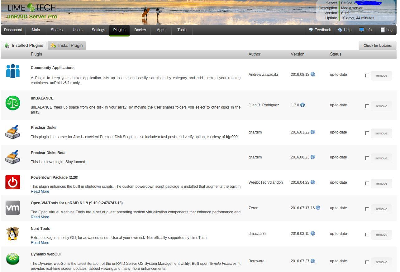

August 28, 201610 yr I installed the beta for 6.2 on my 6.1.9 and it works. How? The beta version of the plugin is actually set to uninstall itself because the beta version is now deprecated (although the "real" version of the plugin doesn't appear to work either)
August 28, 201610 yr Author I have both versions installed. Not sure how or why it works. But it does.
August 28, 201610 yr Which version of each do you have? You must have installed them before the recent update. I have the last good version of each, Preclear Disks 2016.03.22 and Preclear Disks Beta 2016.06.23. There were newer versions of both made available a few days ago, namely Preclear Disks 2016.08.26b (which, as Squid points out, appears to be broken) and Preclear Disks Beta 2016.08.26 (to remove the earlier version). I've avoided updating for the time being.
August 29, 201610 yr Same versions as me. If you currently have a working solution it would be best to avoid updating for a while and keep an eye on the support thread: http://lime-technology.com/forum/index.php?topic=39985.0 EDIT: I've just checked and there's a new version 2016.08.28 available but no mention yet in the support thread.
