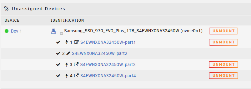

April 12, 20233 yr Reviving an old thread here. I have the same problem. Popped an older 1TB NVMe drive from my old PC into my Unraid server and want to use it as a cache drive. I formatted it, but forgot to delete the partition, so I need to be able to either remove the partition or repartition it. I wanted to try this solution, but the Beta Preclear plugin doens't seem to exist any more. I've found the "Unassigned Devices Preclear" app, installed it, but it doen't find the drive, even though it's under "unassigned devices". I've now mounted it, but it still doesn't find it. See below. What can I do to preclear this drive? Or remove its partitions in a different manner? If all else fails, I guess I could pull the drive from the Unraid server again, but that's kind of a hassle since it's not easily accessible, so I'd like to use that as a "last resort" kind of option. Thanks!
April 12, 20233 yr Community Expert 1 minute ago, BartDG said: What can I do to preclear this drive? Don't preclear flash devices, to wipe it run blkdiscard -f /dev/nvme0n1
