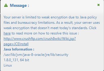

Hi guys,
Ive installed "CrushFTP" docker and when im in UI it tells me to update java (see pic) i tried to go to unraid dir and copy the file...but not able to. Even ive realised that on unraid is version 7 and 8 is already out.
Or is it Java in docker?
How should i upgrade it? Thanks!
This is purely a docker issue with the particular docker you are trying to use..   There is no Java installed at the unRAID level.
the 2nd picture its from Unraid root folder, so something its there...
Anyway how to upgrade the one in docker?
Not in my unRAID root folder. You must have some plugin installing it.
You can access the command line inside any docker like this:
