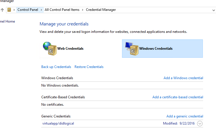

September 23, 201610 yr I think this is usually a Windows problem (if I skimmed through this right). Are you absolutely sure you removed the credentials, using the Windows Credential manager? Then immediately tried to access the share using the correct user and password?

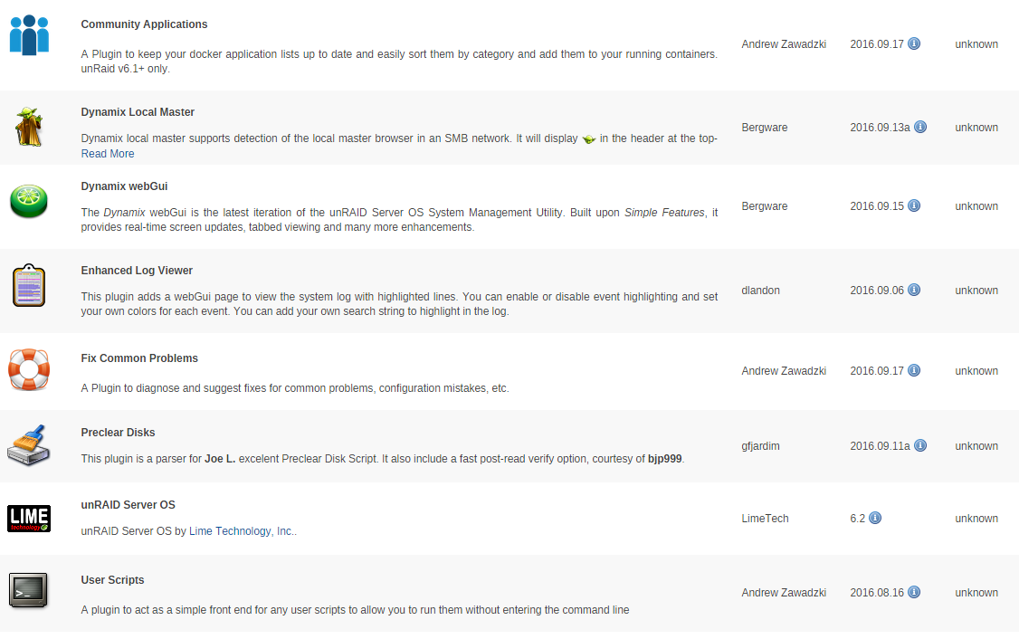

September 26, 201610 yr Author Was able to solve this issue by removing unmenu and it's packages (http://lime-technology.com/forum/index.php?topic=11764.0), removing all plugins and rebooting the server. After the reboot I was able to access all shares without an issue. I haven't started adding plugins back one by one to see which one was causing the issue yet.
