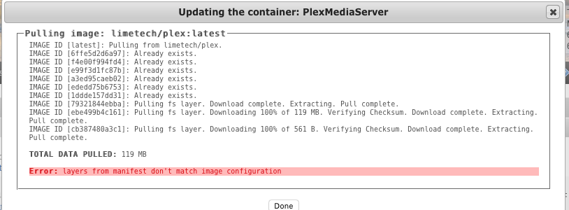

After upgrading to 6.2.1 the dockers I have installed want to be updated and some of them did update, however some of them didn't.  For example Plex is not updating and it gives me the following error;
Error: layers from manifest don't match image configuration.
Anyone know what that means?
Thanks!
Well described bug, have a look at the docker faq in the stickies in the docker forum.
Hmm, no I haven't...however after reviewing the instructions they seem a little extreme.  I'll give it a shot...I hope I don't need to reconfigure all my dockers...that would be a very sad day, night and day.  Below are the instructions given...
What do I do when I see 'layers from manifest don't match image configuration' during a docker app installation?
I have a theory as to why this is actually happening, unfortunately I am unable to replicate this issue so I cannot test the theory.
As to the solution, you will need to delete your docker.img file and recreate it again.  You can then reinstall your docker apps through Community Application's Previous Apps section or via the my* templates.  Your apps will be back the exact same way as before, with no adjustment of the volume mappings, ports, etc required.
This is a one-time operation.
While it seems to be extreme, its actually not, and the net time required to get back up and running like nothing happened is ~ 5 minutes (assuming that you're not on a dial-up internet connection)  (And its a hell of a lot simpler than doing it on a per-container basis (since multiple containers are going to require the same fix), not to mention that you completely avoid the command line.  http://lime-technology.com/forum/index.php?topic=40983.msg499594#msg499594) - as an aside, this is because of changes implemented at dockerHub, not because of an issue with unRaid per se.
So long as you re-add the apps via CA's previous apps section, the templates will already be filled out for you the exact same way that they were running before.

Here's an explanation from erics about why upgrading to 6.2 may cause grief with existing docker Containers:
Docker migrated to a newer API / storage backend for all the Docker containers almost a year ago and has been maintaining the old and new backends up until a couple months ago.
The problem was the 'layer ids' that made up Plex, for example, in the old backend didn't match the same layer ids for Plex in the new backend, even though the contents were the same. So time went on and we kept pushing out updates for our Plex container. Eventually the old backend stopped getting the Plex updates when Docker stopped maintaining the old backend. At that point, unRAID 6.1 (older version of Docker), would use the old backend to pull down layers. So when you pulled down Plex initially it used the layer ids from the old backend. Some of the layers, like ubuntu, are probably even "shared" with other installed containers.
When you upgraded to unRAID 6.2 (new Docker version) there were now updates available for Plex because the new backend was being used by default. The Plex update, now coming from the new backend, only needed to pull down a couple of the updated layers. It skips the ubuntu base layer because it's already installed but that's the problem since the ubuntu base layer (and possibly other intermediate layers in Plex?) have the old layer ids but the new Plex container expects all layers to have ids from the new backend you get a Error: layers from manifest don't match image configuration
Instead of deleting the docker.img, you could alternatively fix this issue by deleting any other container that shares a layer or base image with Plex, essentially purging out layers with old ids, but it's a little tricky to tell which containers do (or maybe all?). So much easier to delete the docker.img and be done with it... at least until Docker decides to migrate to another backend/API again  ::)
