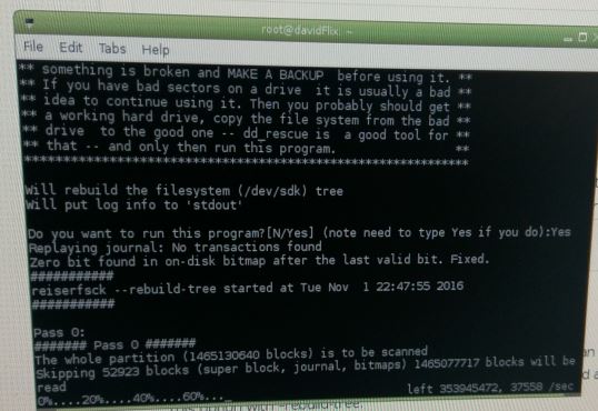

Last night I got an alert that my array was down. I saw that one of my new drives that I added a few days ago was unmoutnable. I tried shutting down the array and rebooting but the drive was still unmountable. I then went into maintenance mode and tried to do the fix drive errors which did not help. It then pointed me to run xfs_repair -v /dev/sdk which I did and it told me that a super block was missing. Which then pointed me to run reiserfsck --rebuild-sb /dev/sdk to rebuild the superblock. This failed and told me to run --rebuildtree which I am doing on that drive now. SO... yeah , did I lose all my data on that drive ? It is currently rebuilding or something but I did not have a parity drive yet. The other 6tb drive I had to make parity did not pass test and I was waiting for a new one. I just setup unraid on this a few weeks ago. Any help would be great as I am in deeper than I now understand.

You should have asked for help earlier.
You can't use only sdX, you need to add 1 for the partition, but although that would work it would make your parity out of sync, on unRAID you allways need to use the mdX identifier, replace X with the disk number.
xfs_repair is for XFS formatted disks, reiserfsck is only for Reiser formatted disks.
If the disk is XFS abort the current check and do (with the array in maintenance mode):
xfs_repair -v /dev/mdX
X=disk number.
Maybe you can still salvage something.
