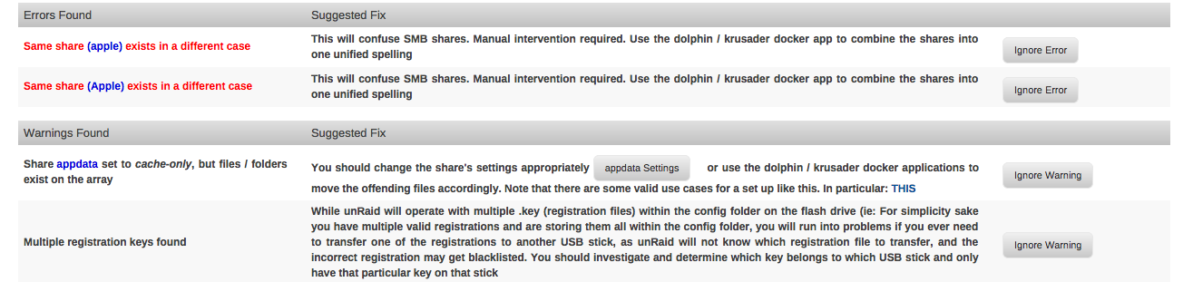

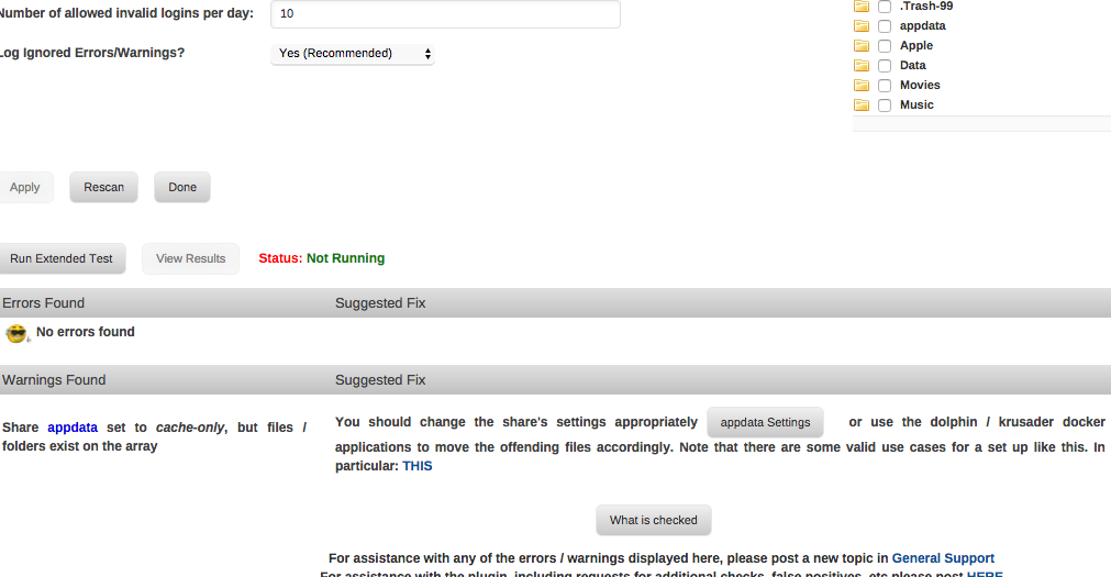

I've gotten this warning from my UnRaid Box and would appreciate help on how to resolve:
Please see attached picture.

What part of the suggested fixes are you having trouble with?
Hi Trurl,
All of them.  I have both Apple & apple and really haven't figured out how to combine them.  Midnight Commander ????
Also the appdata cache only, but files/folders exist on the array??>

mc would be the easy way (or the dolphin / krusader docker apps).  Move the contents of one of them into the other, and then delete.  But, as I recall one of your older posts stated that it kept on coming back, so you've got to investigate which plugin / docker app is creating the other folder and fix it.  BTW, I have no idea if the same name but in a different case affects AFP or not.  I do know that it really throws SMB for a loop with strange results happening depending upon what phase the moon is currently in.
This is easy to fix.  Set the appdata share from "cache only" to be "cache prefer", stop the docker service, and then run the mover from the main tab.  That error should get fixed after mover is finished.

mc drives me nuts also (and I just can't be bothered to learn it properly).  If I had this problem, then I would install the dolphin docker app and do it via something that actually operates the way computers are *supposed* to work nowadays rather than a throwback to how they operated 20 years ago.  IE: a GUI.
With dolphin, navigate to ROOT, then select /mnt/user/apple.  Highlight everything in there (CTRL-A), right click, cut, then go to /mnt/user/Apple and paste it there.  Why aggravate yourself more than necessary.

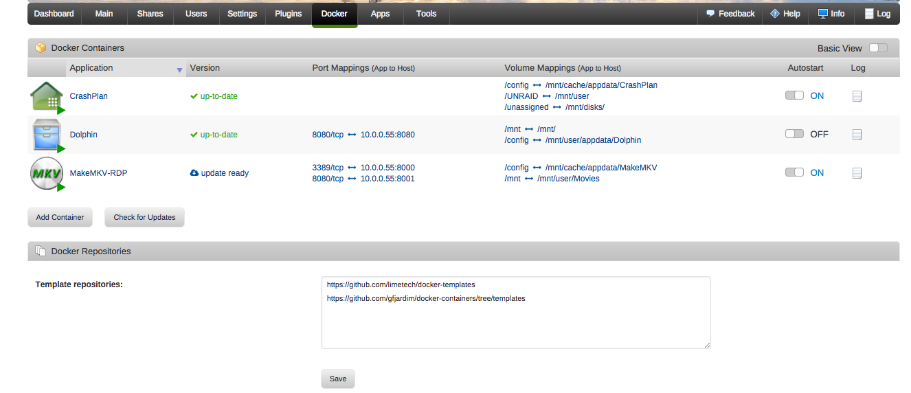

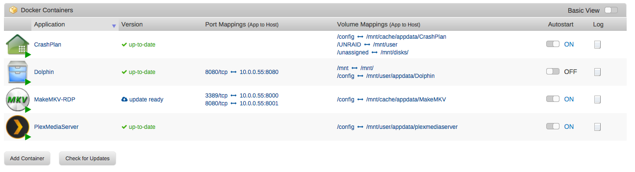

Probably the best thing to do is to post a screen shot of the Docker Tab.  It'll have all of the volumes listed on it for each container, so we can go from there.  Might be best to do this before hitting Dolphin so we can stop the apps from messing this up again after we fix it via Dolphin

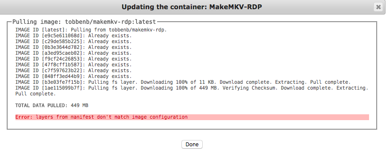

Here is a Docker pic & while at it a problem with my MakeMKV-RDP Docker that I tried to update just now.

If its a docker application that's created the Apple/apple problem, then its Crashplan.  You would have to check within the UI for Crashplan to make sure nothing is going there.  Or maybe you inadvertently created the extra share yourself (via a command line or something?, or its a plugin that created it)  If you can't find what caused it, then just go ahead and use dolphin to fix it, and then we'll see if it comes back.

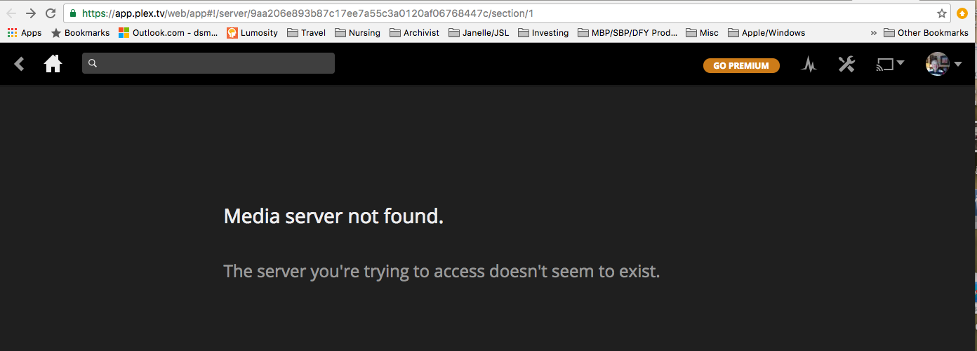

Why Plex doesn't work is because it doesn't have access to any of the shares on the system at all.  You need to add another path of /mnt mapped to /mnt.  Then within Plex add media to a library from /mnt/user/whateverShare.  Similar issue with MakeMKV.  Everything it creates would wind up within the docker.img file, or within the appdata share (depending upon how you configure it), but either way it has no way to read any of your pre-existing media
The images don't match manifest is a onetime issue caused by changes at dockerHub, and needs to be fixed by doing this: http://lime-technology.com/forum/index.php?topic=40937.msg481138#msg481138

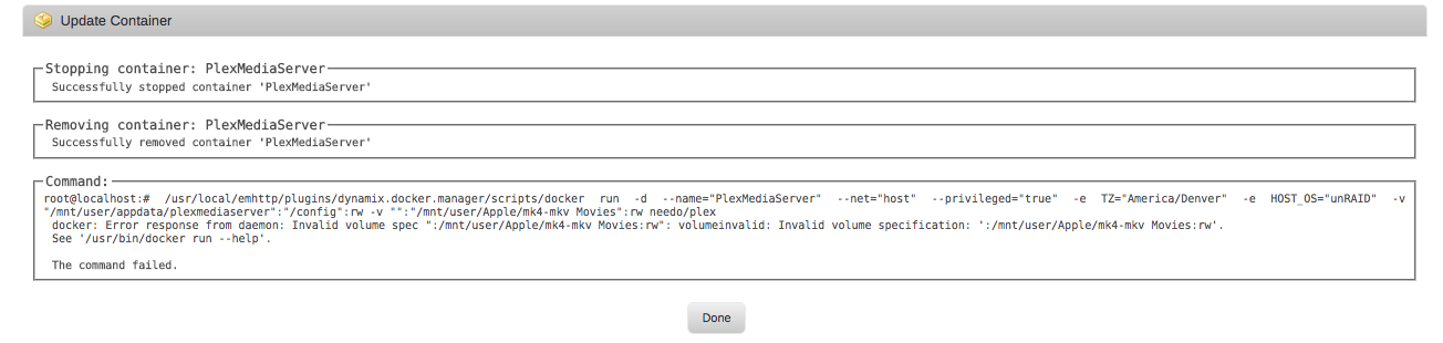

Anyway, thought I would post some of the changes that I made followed by "failures".

PS - When I changed the Plex config it failed and was eliminated
You've set the container path to be Movies, but it should be /Movies
, but when I changed the MKV it accepted but then won't update??????????????????????????????
You still need to follow that link to fix the layers from manifest error.

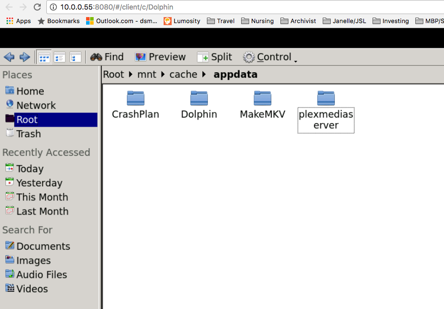

I started Dolphin and was able to delete apple/m4v-mkv (blank) while retaining Apple/m4v-mkv (including all the movies listed).
When I looked in my Appdata folder it showed 2 different Plexmedia server setups or ???

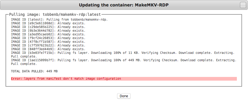

I then went to settings and "turned off" dockers, then back on but still have the same update problem with MakeMKV - it still fails to update - layers from manifest don't match image configuration.

Yeah, you need to delete the docker.img and then re-add the apps via CA's previous apps section.

Plex is the same old thing, doesn't find my Movies or Server.  I did not try to update the Plex settings (inside Plex) but I thought it would see the Share Apple (where the M4V-MKV movies reside).

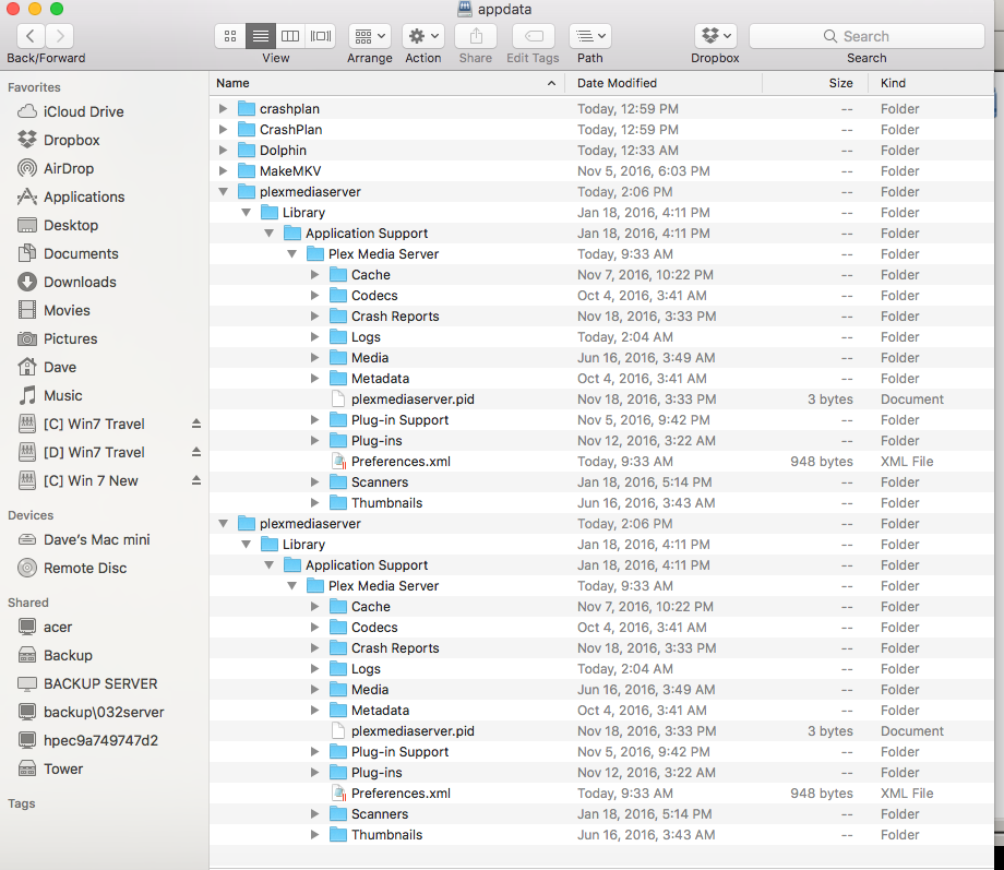

When I looked in my AppData folder I found 2 copies of CrashPlan and 2 copies of PlexMedia Server listed (though both of the Plex versions appear identical - again 1 Plex & 1 plex).  However in Dolphin only 1 each exists.
Finally Fix CA still says I have a problem with AppData Data & Shares existing on the Server.

Reboot, and then look at what unRaid says exists again.
plexmediaserver being in there twice should be impossible (unless there's a space after one of them in the folder name)
CrashPlan vs crashplan.  Possibly existed before, but FCP doesn't catch that unless it does the extended tests (as its not a share)
Plex not seeing the movies.  If you have /mnt mapped to /mnt, then you've got to add /mnt/user/Apple to the plex library.  What I see is that you don't have that /mnt <--> /mnt mapping done in the template.
Post the screen shot of the docker tab again after you reboot

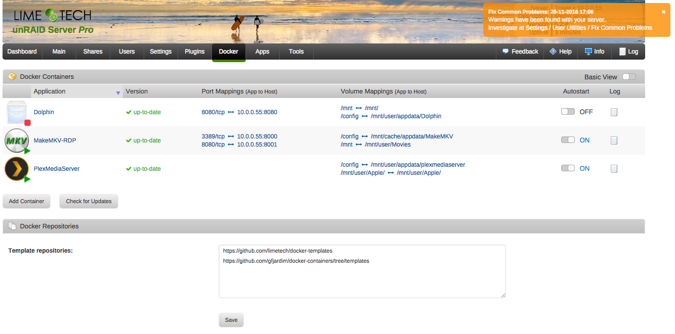

I've rebooted and have a copy of the FCP for your review along with a copy of my Docker's settings.
I tried Plex to see if it could see my Server - no and w/o seeing it I can't create any linkages to my Movies in Apple.
I still have 2 Crash/crashplans and 2 Plex/plex(s).  Should I totally remove Plex and attempt to start over?  Not sure what my actual settings should be, but if I remove everything then go to Dolphin and delete both Plex(s) (or manually via Finder) and the same for Crash/crashplan(s) then maybe everything will get cleaned up.
FCP still shows an error re: Data/Shares
Crashplan:  I'm going to guess that at some point previously, you've redone the template for Crashplan from scratch.  Since crashplan isn't currently installed, I can't tell which one that its supposed to be using for its config folder.  If you re-add it, and then switch it to Advanced view in the top right, and then hit Show Advanced Settings at the bottom, you'll see what the config folder it's supposed to be using.  Delete the other one.  You might need to use Dolphin to do that if you run into permission problems.
Plex:  Best guess is that there's a leading (or trailing) space on one of those seemingly identical folders.  If you try and rename one of them within Finder, then you should be able to determine which has a space.  Delete that one.
This is an easy one.  Go to settings, docker settings, and disable docker.  Switch the appdata share on the share setting from use cache:only to use cache:prefer  Then on the Main tab run mover.
All remnants of the appdata share will get moved to the cache drive.  Then re-enable Docker
