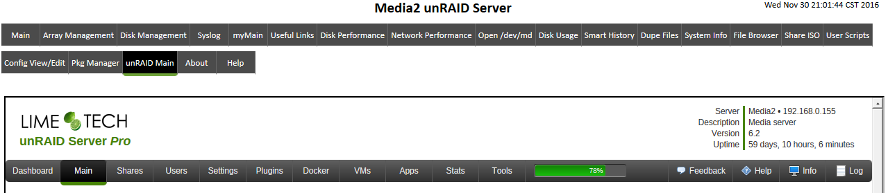

I don't use unmenu any more but it will run on 6.2 see graphic.  unMenu won't install any more on ANY version of unRAID (as far as I know - but maybe that changed since I last tried to install it) you have to copy it from an existing setup.  See attached graphic (note I'm a little behind on my versions of 6.2 but don't expect that makes a difference).
I tried to run it on my server (as I mentioned its 'carried forward' from unraid 5.x)... and it runs just fine...I've disabled it in the GO file, will run without it for a while and see if that makes a difference...
