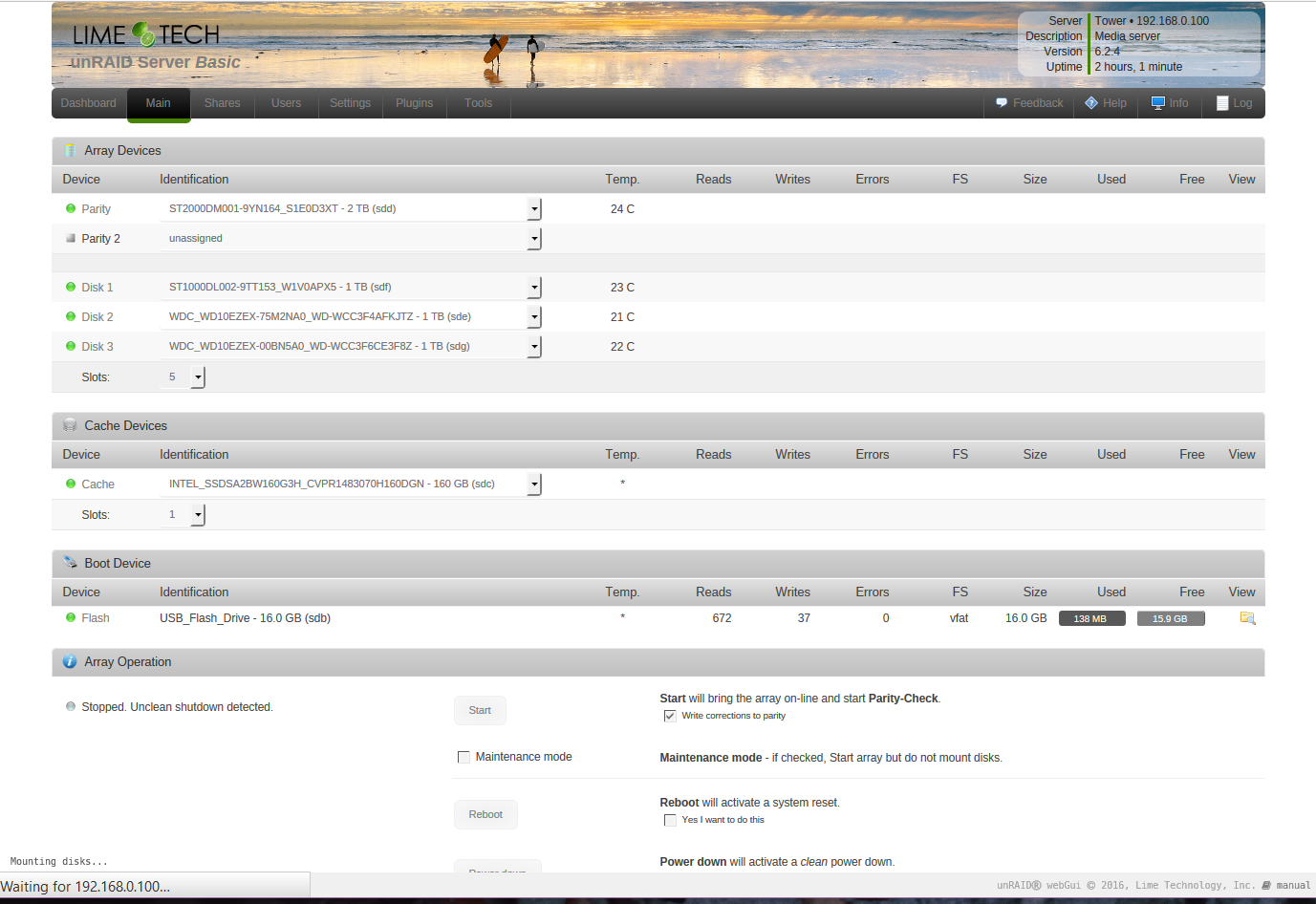

Ok.  Bought a new flash drive.  Loaded the latest version, and copied the config files, minus the go file and the docker file, plus the shares folder.
Booted up, and I was able to access the webconfig page once again.  Problem solved!
Except ... before loading the plugins described in your doc, I noticed that the drives were not mounted because an unclean shutdown was detected... stupidly, I tried to mount them.  That was about an hour ago, and the server has been hanging since.  Page is spinning, not timing out, but not refreshing.
Is this purely a goof in my order of ops, an indication of a corrupted file in that config folder, or an issue with my drives do you think?
Did you get a new Key File (or apply for a Trial registration)?
Did you just start the Array by "Main'  >>>  'Array Operation' --- Then clicked "Start"?  If you did this, then a parity check would have started since an unclean shutdown was detected.
But you should still should have been able to navigate to other tabs on the GUI and there should be a progress line for the check on the 'Array Operation' page.
Can you get to the command line (either on a monitor and keyboard attached to the server or with PuTTY)?  If so, type  diagnostics  at the prompt.  That will write the diagnostics file to your Flash Drive.  It will be in the root or the  logs  folder.  Attach that file to your next post.
Got the new/replacement key file in place.
Started at Main >> Array Operation.  Can't navigate away from the page though, and there is no indication of a parity check like there normally is.
I can go for the diagnostics file, but it looks like that will require a hard shutdown -- it has been "mounting disks..." for 2 hours now with no changes.  Is it safe to go ahead and reboot manually?

Its disk 3 causing it
Dec 10 03:55:46 Tower kernel: XFS (md3): _xfs_buf_find: Block out of range: block 0x7fffffff8, EOFS 0x74706d70
  Need to run check the file system on disk3

So I read through the guide here (https://lime-technology.com/wiki/index.php/Check_Disk_Filesystems).
It's been a while and I don't remember what file system I originally set up on them, and I can't see in the GUI, because they won't mount.  Looking over the error you excerpted, I made the assumption that it's xfs, and so I ran the following command through an ssh terminal.
xfs_repair -v /dev/md3
But, the system has not responded.  I saw that it can take up to 30 minutes, but the doc also indicated there would be a running report output.  Instead, I have waited 30 mins, and nothing has happened.  The GUI is still refusing to load, so I don't know if it's still trying to mount the drives, and that's what's preventing the check?
I looked at the instructions and saw this line:
Start the array in Maintenance mode, by clicking the Maintenance mode check box before clicking the Start button. This starts the unRAID driver but does not mount any of the drives.
I suspect that you are going to have to force a reboot and this time, follow the instructions explicitly.

Will umounting disk1, disk2, as well as sdb1, and sdc1 (if necessary) be equivalent/sufficient?
Disable array autostart by editing disk.cfg on your flash drive (in the config folder):
change startArray="yes" to "no"
Reboot and run xfs_repair in maintenance mode.
Thanks Mr. Black, that did the trick.
